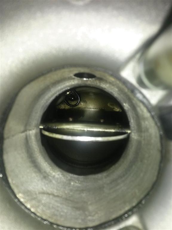

    G'day All,
    I was on my way to Throttle Roll 2014 this morning when after filling up with fuel I went to leave the fuel station and the bike stalled. Strange I thought, restarted and of I went, then I got a little further down the road and when I stopped at a set of lights the bike stalled again. So again restarted but the bike wouldn't idle. I had to hold the throttle on slightly to avoid stalling. So I headed home and removed the air filter thing the throttle body may be dirty, but it was reasonably clean. However he wire sensor is looks wet, as shown in the pic below. Now should this look wet? and if it shouldn't look wet can I clean it by spraying carby cleaner into the throttle body and leaving for half hr or so to evapourate? I don't tune the bike myself, but it has a 103kit, SEPST and Short shot pipes if that changes anything. It kind of seems if the idle settings in the computer just dropped out.
    Any help would be greatly apprieciated.
    Ryno

  • cm364352
    cm364352
    I would try flushing the IAC out.That's the hole at the top in front of the throttle blade ,shown in your pic.
    I just use WD spray for this,with the plastic hose fitted to the spray nozzle.shove some clean rag into the throttle body to catch the gunk.
    stick the spray nozzle into that hole in front of the throttle blade and give it a good flush out.You will see the spray coming out just behind
    the blade from the top.
    P.S I've also used map sensor cleaner for this,supose carb cleaner would also work.
    WAZ...
