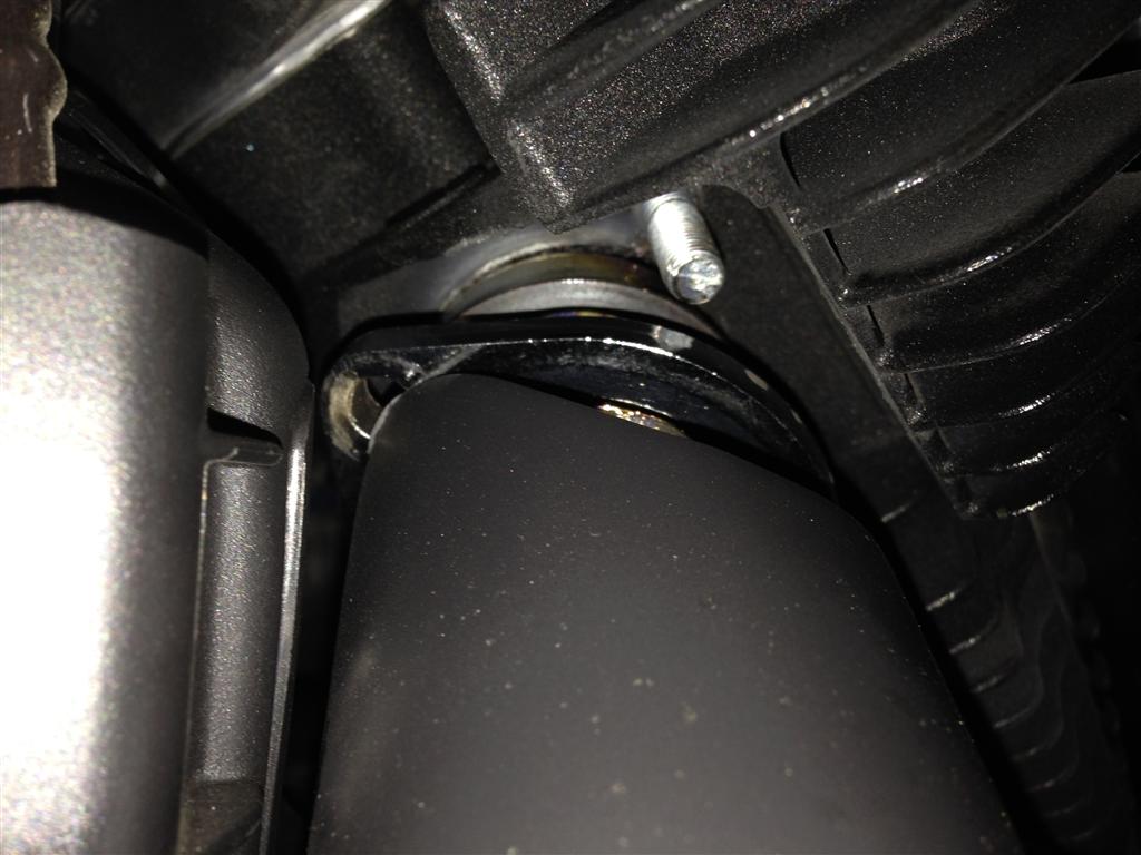

    I noticed on my way home this evening (just as Melbourne decided to turn on the rain) that the usual growl I get from my iron sounded somewhat more "airy". Putting it down to a different environment, rain, traffic etc. I didn't think much of it until I got further into the ride and heard what seemed to be something metallic vibrating around - odd I thought! First thing I did when I got home was to check the exhaust only to notice that my exhaust hader was missing its nuts! (see pic)
    Obviously I'll be onto the dealer first thing in the morning as the bike has only just clocked over 1,000km (as a result I can't say I'm impressed).
    My big question is - could this cause any serious damage? I'm guessing I'll need (apart from the nuts) a new gasket - but could the lack of back pressure cause serious harm to the engine?

    Thanks Mark... I have no doubt that's what they'll say, but will see. As far as catching it early - the bike did around 50km (that I know of) with them missing, fingers crossed it'll be ok
    After such a short distance its unlikely that there is any motor damage other than Harley waranty cheque book!

    if the bike has only done 1,000Km, then I got a couple questions....
    a) stock pipes or have you have the headers changed?
    b) any wear marks on the studs?
    give then fact there is so few km, Im guessing that nuts may never have been fitted in first place. Difficult to imagine both nuts coming off same time in less than 1,000Km.
    There looks to be marks on the flange which might be score marks from nuts!!!. Any better pic of the studs?
    I have a Dyna and rarely have to tighten flange nuts which makes me think someone left them off. Wouldn't be the first time.

    Thanks for your response Uncle Ho...
    a) headers have been changed - V&H short shots fitted by the dealer when I purchased the bike
    b) hardly any wear marks on the studs from what I can see
    Better pic included below...
    I'm guessing they were fitted, but not tightened correctly as there's some marks showing on the flange, but this could have been from the stock pipes anyhow, although as you say with only 1000km on the bike (it's been a fun couple of weekends) they may have never been fitted. Dealer is picking up the bike tomorrow to get things sorted, admittedly very apologetic, but imho not an ideal pre-delivery.

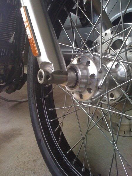

    When I bought my nightster in 2010, discovered after a ride the nut on the front wheel axle was loose and not far from falling off,could have been ugly! Only had low K's on it as well. Picked up the street bob this year and by the time i got it home one of the rear indicator/brake lights was hanging on by the wire only. Love both the bikes, but maybe HD need to look at their quality control a bit better.

    Just adding to this thread from last month, I had a similar issue within 300km from factory on my FXDC.
    I only noticed that both nuts on the front header were missing because I hit the starter and a spark the size of venus erupted from the other side of the bike! Couldn't see any obvious cause once the smoke dissipated, so tenuosly hit the starter again, no sparks and the bike started fine. While having the closest look I'd had at all the mysterious bits in the engine bay (first Harley and not mechanically inclined) while it warmed up, I noticed the front pipe banging against the exhaust port, with both nuts missing.
    Had the dealer ship it from work where I left it (damned if I was riding it like that) back to them, and they found not only both nuts needing obvious replacement, but that the spark had been caused by the starter motor's earth lead arcing on the frame as it had lost a THIRD nut in the middle of the bike's guts. They put a locknut on the earth lead, but explained that a lock nut and\or threadlock wouldn't help with the exhaust as the constant heating and cooling would render both options useless anyway.
    Dealership said these things shouldn't happen on current model Harley's, but must have been missed from the factory. Only problem is I had the dealership install V&H pipes when I bought it, so was def. an oversight at that dealership. Haven't had any more issues with those nuts, but bike has been back a second time because the nut holding the main earth lead for the battery to the frame came loose while riding, resulting in the bike cutting out for a few scary seconds while doing 100kph on the motorway.

    To follow up and give credit where it's due...
    The dealership were great - acknowledging that this should never have happened and arrange for pickup of the bike immediately. Nuts were replaced and bike given another going over from top to bottom by the senior mechanic, ride tested, etc. Transport was then also arranged to get the bike back to me asap.
    Interesting that we've both had pretty much the same experience (although fortunately my starter motor has remained earthed correctly), even down to it being the result of aftermarket V&H pipes being fitted.

    Don't want people going over the top about this photo as it's been commented to death before, but this was the result of workmanship from a HD dealer around 4 years ago..... nuff said
