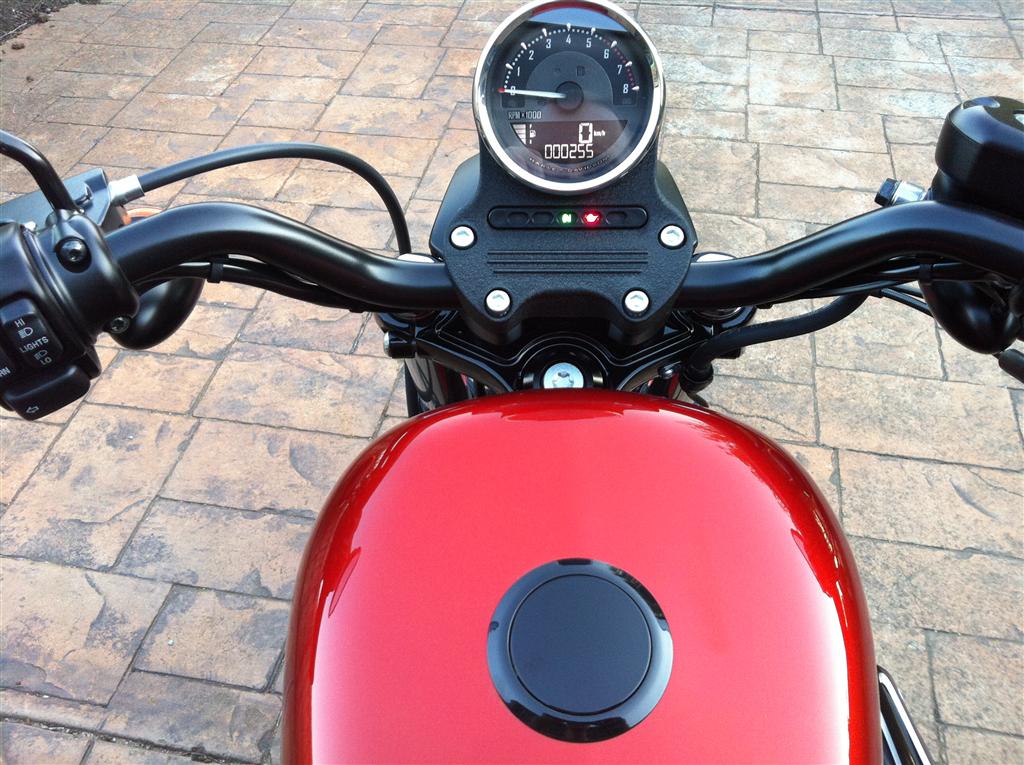

    Anyone fitted a fuel guage to their Sporty?
  • Fe883
    Fe883
    Originally just thought about the "Fuel Gauge" then opted for the New Speedo assembly instead. Now i have a Fuel gauge, Tacho, Gear Postion indicator, Clock & 2 Trip meters.
    The Gear pos. ind. only works when in gear riding.
    It can also be opted to be any color you like to match your bike. Dealers were fitting for free when a service was being done, so got this fitted when i purchased the bike.
  • la0055
    la0055
    cheers mate, looks good !!
    Price?

    I can't find the speedo assembly listed with any of my parts suppliers .... who is your dealer please ?
    I think I must have one.

    My Sporty is an 07 so I will need the fuel sensor, but even with the additional cost I reckon this is good kit.
    Never knowing how much fuel I have worries me.

    I payed $300odd for the Speedo & the dealer Harley City in Brunswick fitted it for free. The part is in the lastest catalogue. Dealers hand them out & are a good read :-)
