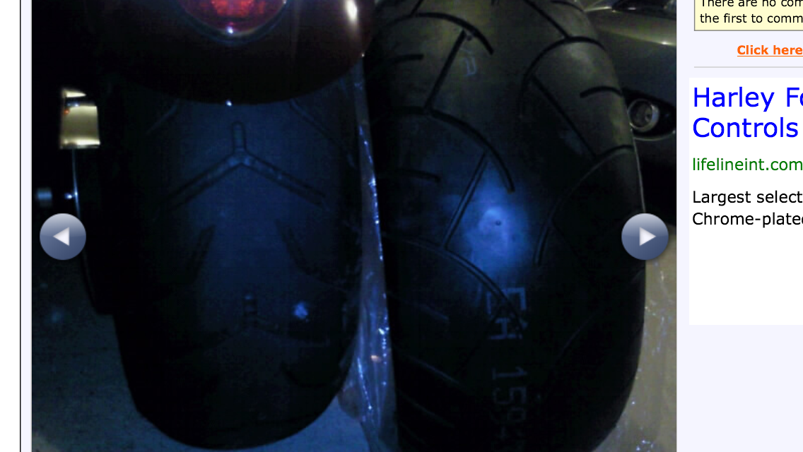

    For what it's worth they work on a rocker which I'm told is the same as a BO
    Here's a pic of the difference on my rocker
    [/URL]
    When I fitted the 260 on the 8.5 wheel I had to go with the narrow pulley & belt to center the wheel properly
