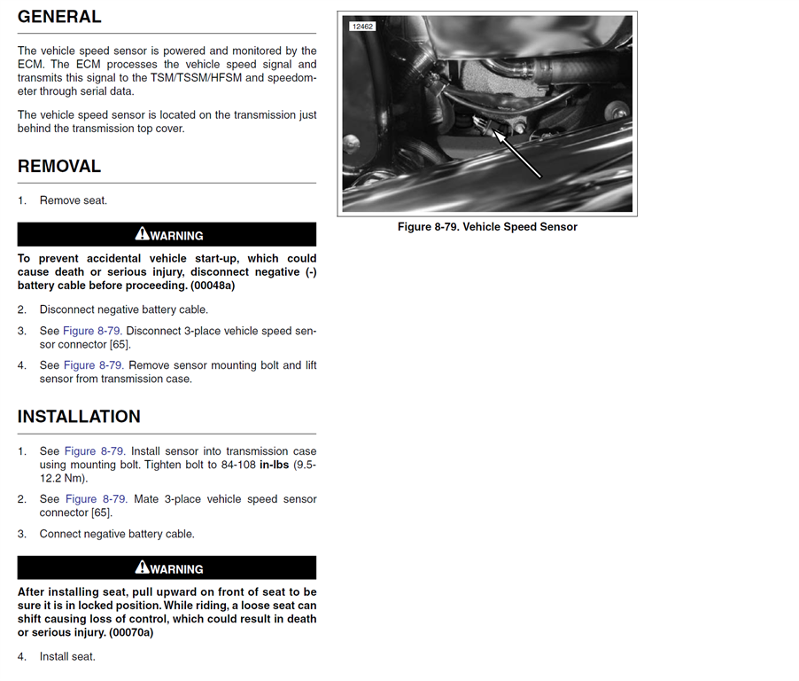

    Mate change the sensor yourself. $300 labour to fit a $70 part. Absolute bullshit. The sensor is located on the top of the gear box just blow the starter motor. An allen key is all you need to replace the part and would take 10 mins if that.
