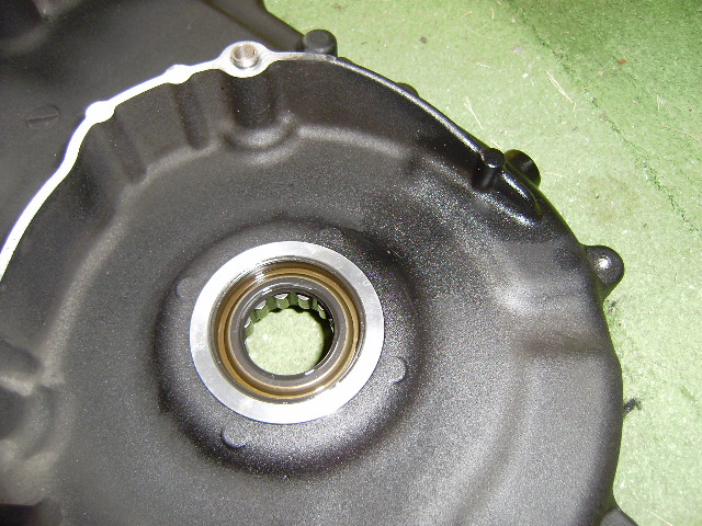

    hi,
    leak at inner primary, this is first new seal i put in, doesnt leak as bad as original leak:
    reckon race walked and affected seal, have to get remover:
    thanks

    Hi,
    Thanks cv ohh, i go careful and see what happens, my race walked out so hopefully it keeps walking out when put remover on it
    I dont have dremel so thought buy the tool
    Thanks
