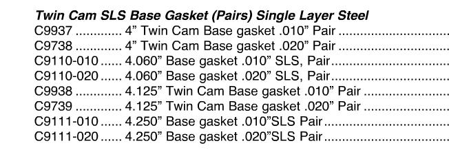

    that is getting a bit much IMHO. it seems from the educated people .030 is minimum and .045 is max with .040 being desired. Often people talk about .030 simpley because the slugs are down the hole and there chasing compression.
    2 possible options, cut the cylinders so your at .000 deck or try to find a base gasket at .010. Cometic make several but do not know what cylinder size you have
    one of these may be right, can but them from several places but may have to order them in some times.
  • Bashful
    Bashful
    Thanks Ozy. The bore size is 3.875. I will chase a 0.010 head gasket, failing that I will get the cylinders decked. I really appreciate your input bloke.
    I will post a pic above of my piston down the hole.
  • ozymax
    ozymax
    you need to measure the OD of the cylinder spigot I don't have a set here to check, and make sure you are chasing Base gaskets not head gaskets.
    You can buy cometic stuff direct from SERCO in Brisbane if you have trouble getting them local or mail order them into Aust I guess
