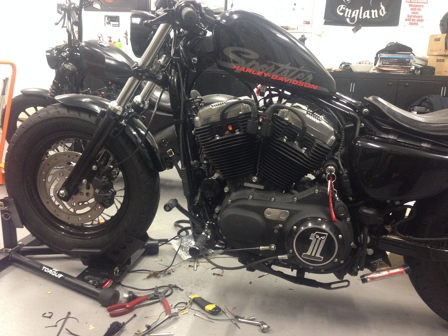

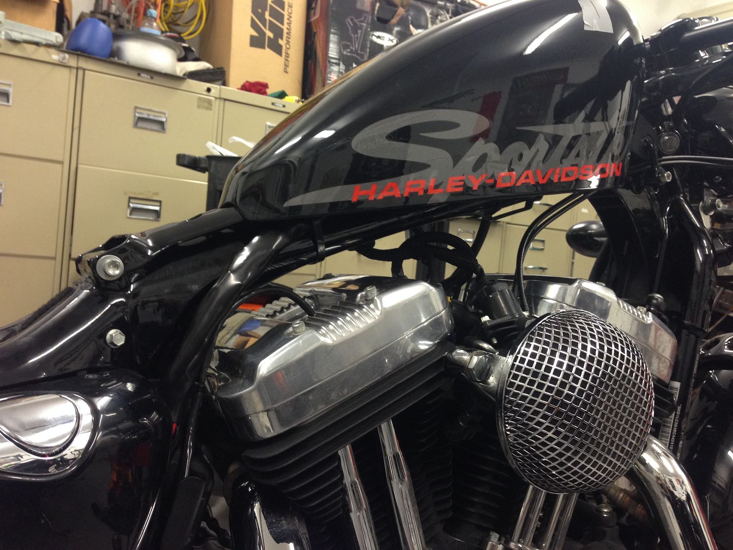

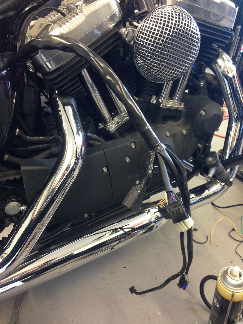

    Yep good product, i went with 2" lift. Get the lot and do it all at once. The only hard part is getting the wiring neat, When i do them i depin all the plugs and feed the wiring thru some pcv loom tube to give it a nice clean finish. If you want to get "excited" you can even hide all the wiring running down the left side of the frame but that adds 4hours to the job....

    Have you got any pics of the wiring through the PVC loom tube and the wiring down the left hand side of the frame Andrew, you have me intrigued ;-).

     - terroristone - Photobucket
