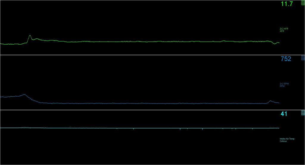

  • tussuck
    Here it is....
  • perthhog
    perthhog
    if 11.7 is the afr too rich 14.7 is stoic more on later model cars / bikes I would say as krash 13.5 14 @idle to that 11.7 for boost/nos mtr at wot but as said
    some mtrs like to be richer or leaner a set revs
  • tussuck
    Cherers guys.... I'll downsize the pilot jet from a 48 to a 45 as I'm only about one and a quarter turns out on the adjuster screw to get the 11.7.
