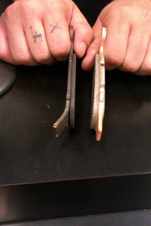

    Ok , pads are out of my 08 Fsxtc ... the Tatt hand ... { not mine } ... is my old pad while other is brand new genuine Harley ... the obvious question is how the bloody hell could this happen .
    Quick back story ... not long before Xmas had stone in belt so had it replaced and at the same time had new RC Components rear rotor put on as well as new suspension ... all good untill  pretty recently started to notice a bit of a rubbing noise from rear wheel ... wasn`t all that loud but thought better have a look at this ... but of course i had to go for a ride .
    Some of you may have seen the lower pic of bubbled tyre i posted recently ... time for new tyre me thinks ... took wheel off and while i was at it got some Lyndall pads and put them in which of course meant taking out old ones and seeing the old bent ones .
    The only thing i can come up with is the guy who put the wheel back on after sorting stuffed belt and putting on the other stuff didn`t put the locator lugs in the locating slots which meant that when the pistons pushed out against pad the lug end bent against the inner caliper ... the confusing part is the one in pic is the one the pistons push against ... the one not in pic is bent as well but in the opposite direction to the bent one here , but that one on a 08 Fsxtc rear caliper dosen`t move so how did it bend ... and if he did the same thing and not locate it correctly then it should have bent the same direction as the one in pic .
    Have been to 3 different Harley shops up here and no one can explain how it happened ... one strange theroy was that the guy in his frustration actully bent the lugs out himself because they can be a bit of a pain to do easily and by doing that he could sit them in there slots so he could get wheel back on ... i don`t know about that one , just real strange ... Rotor ended up getting warped as well carn`t say for sure due to this problem but would seem likely .
    Anyhow any thoughts good people ... Tim .

    Bent pads, warped rotor, After new caliper installed and found at time of new tyre replacement, The finger points at the mech who did the work methinks, Or his apprentice. bugger. That's a new one in my book too.

    Yeah it was young off sider who is not there any more , wonder why ... shop owner real cool and offered to cover my losses but have decided to let it ride and he is going to do the right thing by me on future work ... definitely seems to be one no one has seen as yet .

    Those pads were definately bent at install. no way for both pads to bend outwards on that end while they are fitted and the brake is working. The only way you were going to get them out is with the wheel out of it.
    wasn't the ginger beared fellow was it?

    Ha Ha Ozy ... you got it first go on the possible culprit ... that's the only thing I could come up with , that he physically bent the lugs himself so as to make it easier to reinstall rear wheel , but might never really know ... but like I said shop owner real cool so no dramas from my end just a bit of a bummer loosing my RC Components rear rotor which of course matched my front rotor .
