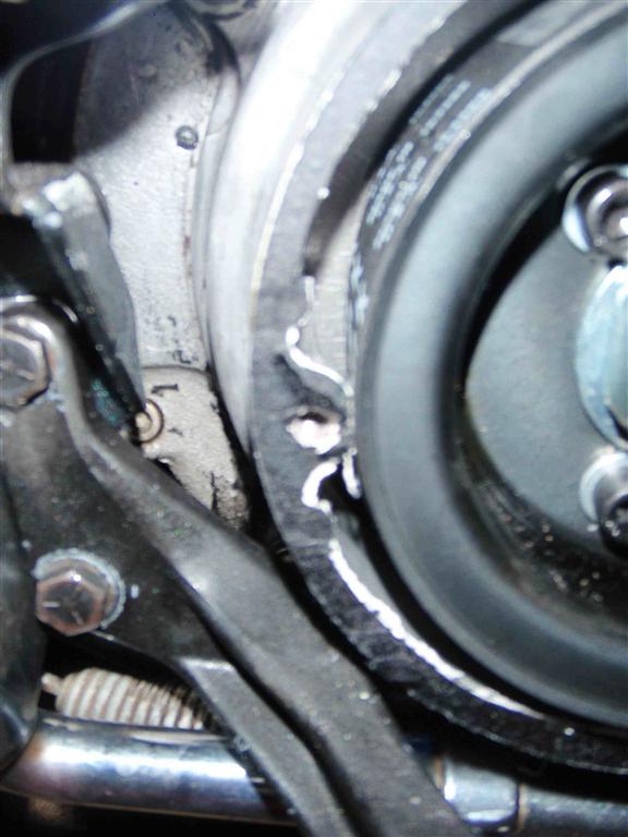

    But,,belt rubbes on inner case bolt section, no mention of having to relieve the case in instructions so wondering if anybody else has had experience in these matters

    you have too get the grinder out , the inner pri is stuff anyways, vent the outer to let some air cool the belt & clutch etc, pre soak the clutch fibre's in ATF oil 1st & keep & eye on the drive tags in the clutch hub they come loose

    So, off comes the inner primary cover for filing clearance.

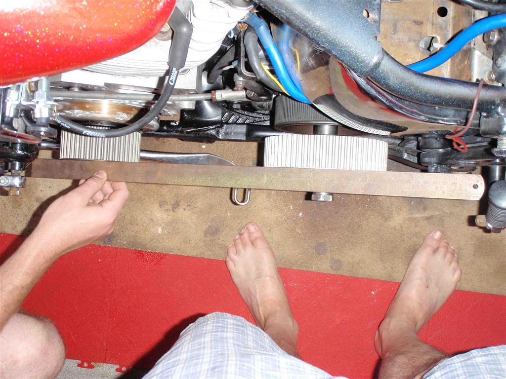

    Just thought I'd do a trial alignment check,,,,looks pretty good to me
    Yes I know its not good OccHealth safety to wander around in bare feet,,,but what the hell its been hot today

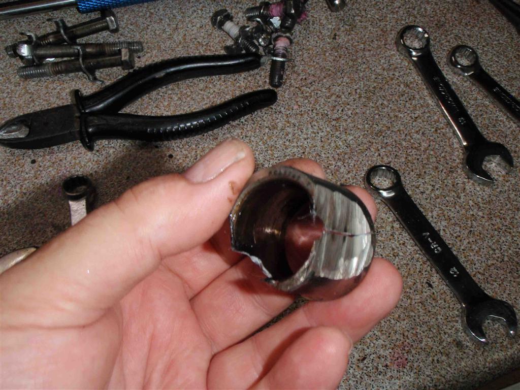

    Friday morning and 10 minutes work with angle grinder and a whack with a cold chisel and off comes the sleeve

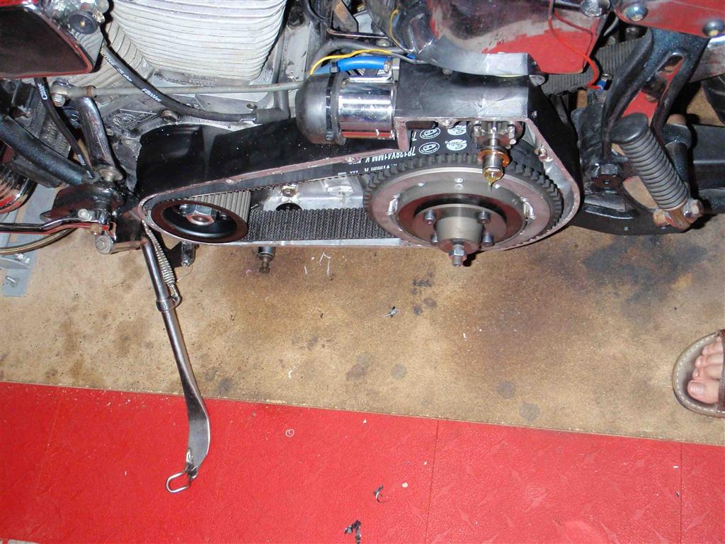

    conrod
    So she is finally in place, will take her for a test ride weekend
