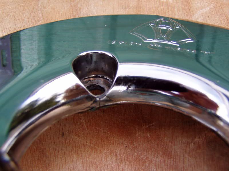

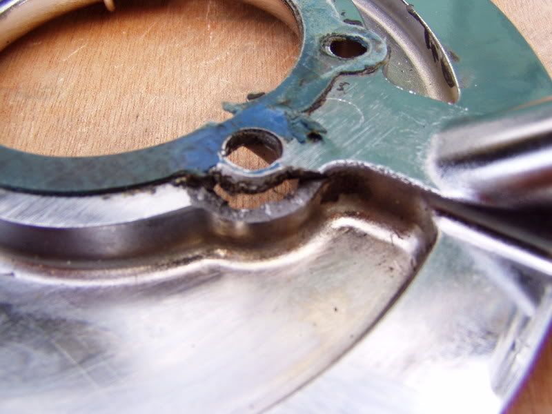

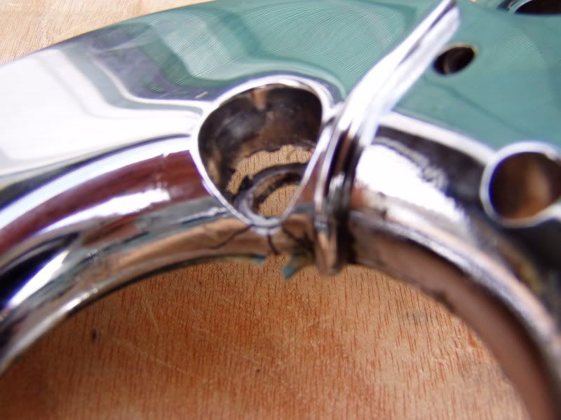

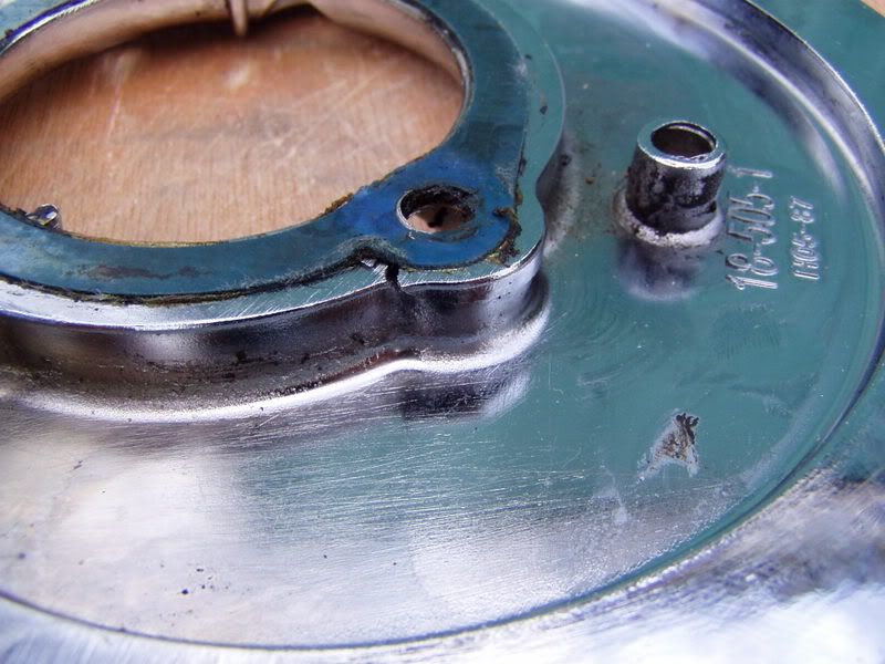

    When installing a Big sucker be careful not to use a lot of force tightening it down otherwise this may happen.
    Tip: Loosen the manifold before tightening the Big Sucker down.

    Have you had the inlet manifold off???
    RT
    No.
    The service manual directions for assembling the air cleaner says to loosen the manifold then tighten up the air cleaner and then retighten the manifold. I think if I had done this I wouldn't have tightened the Big Sucker so much. Oh well was a another lesson learnt.
