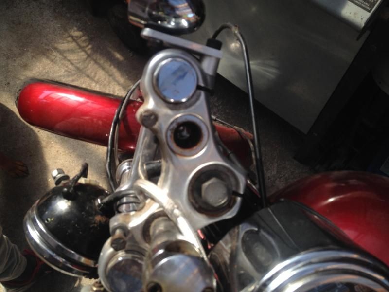

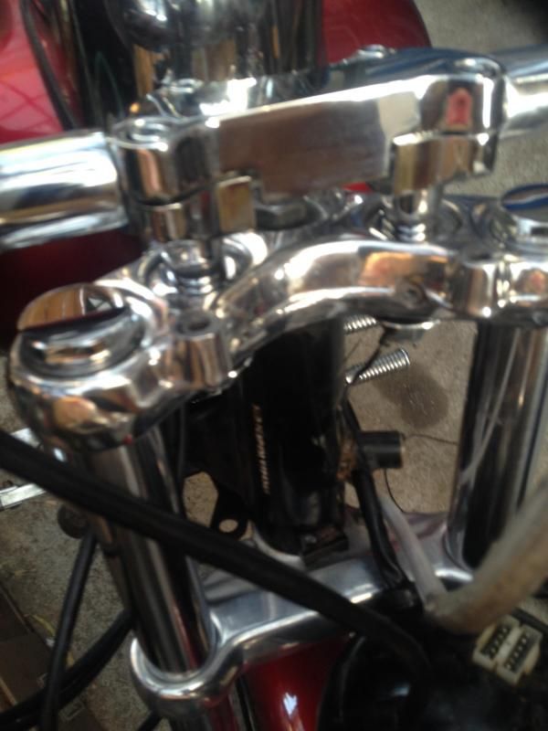

    G'day.
    Trying to fit some stock risers as the ones that were on the bike were too long (4";). The ones i have fitted are 1 1/2" but different in the way they are mounted. The 4" risers sit in some sort of solid bushing and are bolted from the bottom up. The ones i am fitting require a standard harley rubber bush, which i have purchased, but not quite sure how to fit it. Do i need to tap out the bushings in the photo? If so do they come out from the top or bottom?
    The rubber bushings i have are not the same diameter as the hole in the triple tree, does this matter or is there a step in the whole where it is narrower?
    Thanks
  • judgelj
    judgelj
    In case anyone reads this in the same boat. Solid mounts tap out from the ground up. New ones go in one rubber below, on on top, and a crush tube through the middle. dont forget the two washers like i did. Cheers
