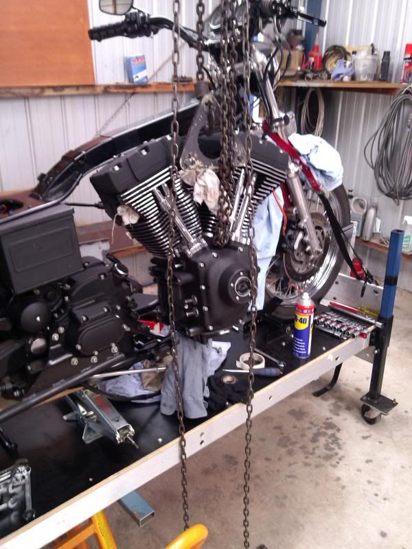

    Easy one man job using a block and tackle, and a steel plate bolted between the head breathers.
    Well that's on a Dyna at least !

    Oops, forgot to mention, my bike stand has castors, so I just push it sideways !!

    It can be handy
    HD engine removal - speedzter - Photobucket
  • ozymax
    ozymax
    yep like I said that's cheating
    nice set up mate

    I would love to see a photo from the other side. Do you have to remove the clutch, primary chain and primary case as the service manual suggests.
  • ozymax
    ozymax
    YES. inner Primary needs to come off so you can get to the rear mounting bolts, and so you can get the alternator off because most of the time they don't come off through the opening.
