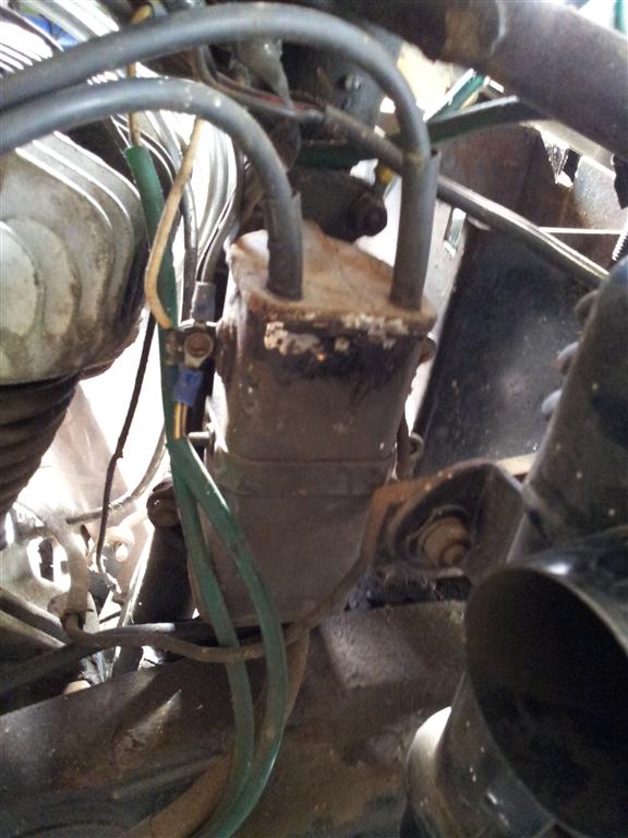

    12V would have definately been an upgrade! Upgraded generator, regulator, battery and lights. If the upgrade has been disguised properly the "untrained eye" would have difficulty spotting the upgrade. Pop the relay cover off (small box on the front right) and check if you have the original dual coils in which case it is still 6V. If the regulator has been upgraded to an electronic one, because the old ones are notoriously unreliable, check what is looks like
    6V - looks like this http://www.flatlandmotorcyclecompany.com/Solid-state-relay-6-volt-4785-38-Prodview.html
    12V - looks like this http://www.flatlandmotorcyclecompany.com/12-volt-regulator-Prodview.html

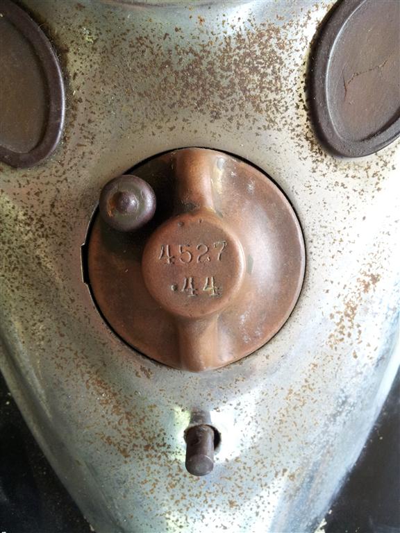

    On the ignition switch there are numbers stamped on it. 4527 .44. Anyone know what these numbers indicate? See pics.

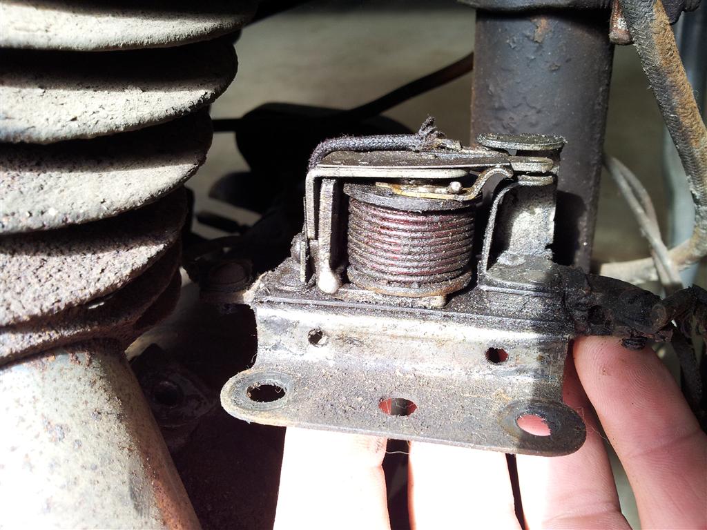

    Looks like its 6 volt.

    Looking at your pics it is a 6v system , numbers on switch may be part number last two numbers everything Harley is design year, some places to contact everything flathead here in oz are Mark Austin Pacific Harley Trading and Redferns in Sydney , Colt at Harley Development in Melbourne and possibly K&M in Adelaide. Other Flat Head Freaks may be able to suggest other shops who deal in early HD. And yes as previously stated no battery no go , when you do get it to run make sure you pole your genny. You can get repo flat head manuals and l am sure you can get them from one of the crowds l mentioned. Also yours looks to me it is the WLC which is the civilian model, but l may be wrong

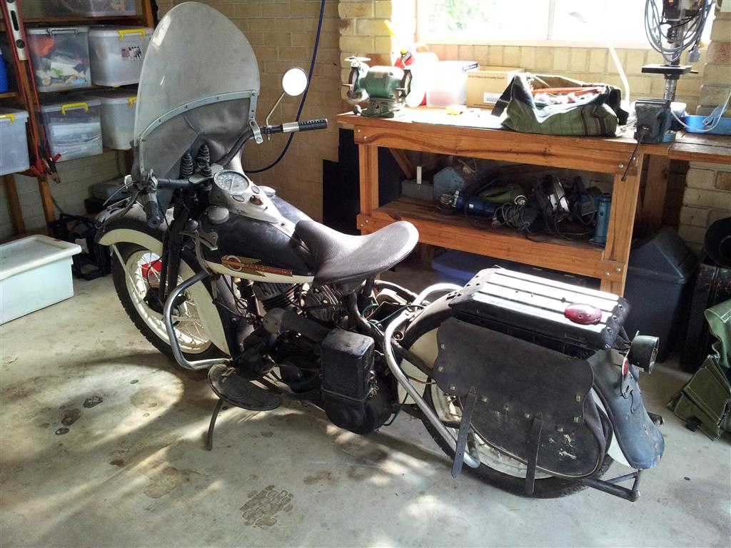

    looks like a good project - "everything" seems to be there. Seems to be a civilizied WLA as the fenders are civilian fenders with the side valances
    - not sure if those are the original tins. From the relay photo its a 6V system.

    oh yes, the numbers on the toggle switch dont mean anything - well at least not to me. Check of the left hand side of the motor -
    first two number indicate the year of manufacture, last four digits are the serial/series number. Frame doesnt have a number - Some people
    copied the engine number and placed it on the frame to make the registration process easier
