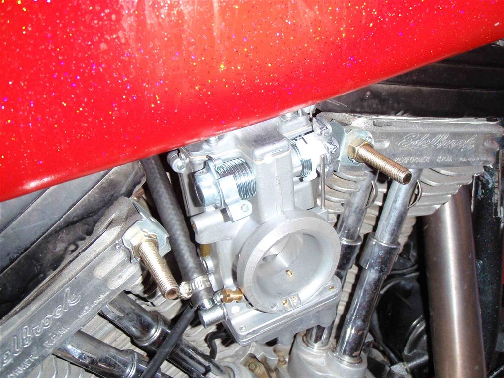

    Decided to replace the S&S "E" with a Mikuni, so whipped it off and on with the Mikki, only trouble was the choke cable was too short but a few minutes with a soldering iron and some spare throttle cable and had that sorted.

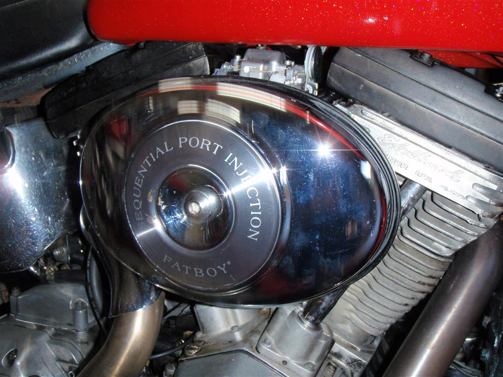

    Made some studs to mount the aircleaner,
    Some filing on the two mounting holes in backplate to get it lined up and she looks like it grew there.

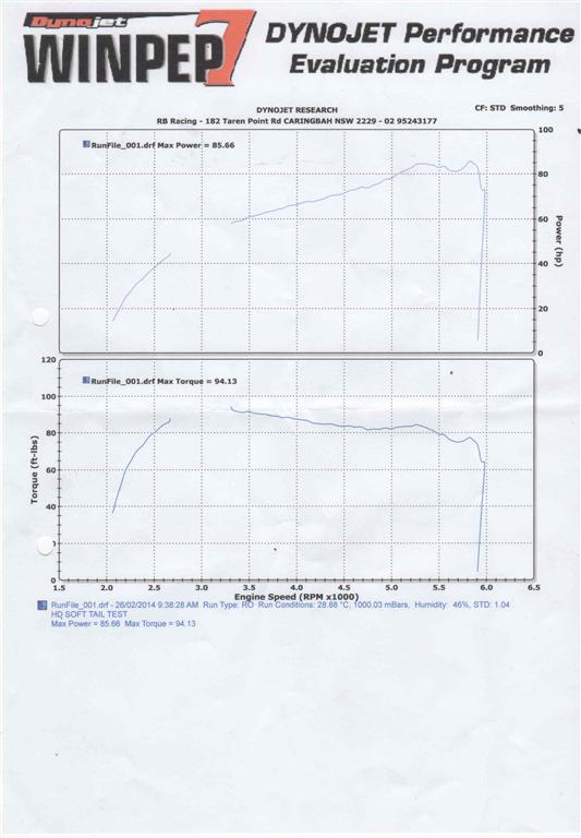

    Just had her dyno'd .The mixture was spot on through the rev range, all we had to do was 1/2 turn richer on the idle screw and lower the idle speed. Check out dyno sheet

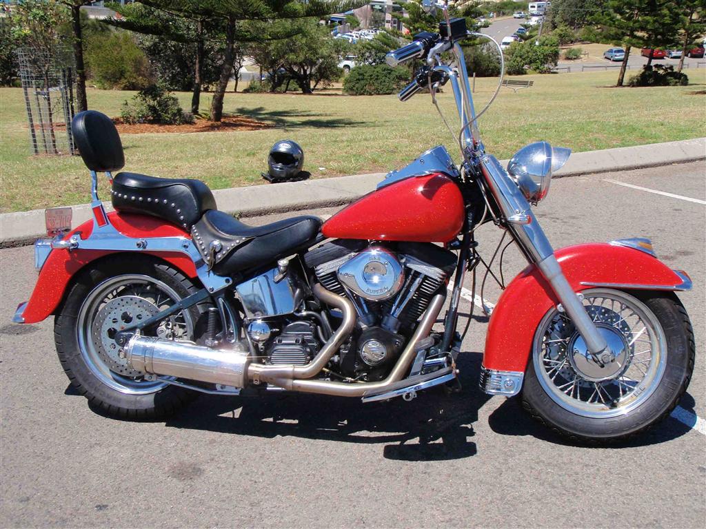

    Dyno Harley, I am running a 2 into 1 supertrap with a real muffler I picked up at Silverwater wreckers, biggest straight throug that would fit, dont know what it came off, see photo
