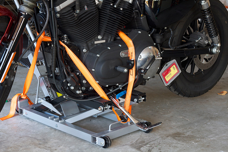

    Step 1: First things first. You're gonna' need the following tools : A bike lift, Torque Wrench, A pretty massive Size 50 Toque Bit, Some sort of Thread Locking Compound such as Loctite which you should be able to get at Bunnings or Super Cheap, and a size 19 spanner.
    Step 2: Get your bike onto the lift, and get the bike only just off the ground. You don't want the back wheel to be more than about 2-3 cm off the ground. I kind learned that the hard way haha.

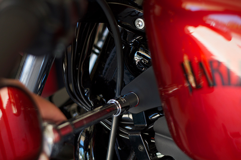

    Step 3: There's only two bolts on each shock that you need to remove in order to remove the shock itself from the bike. To remove the top bolt, you'll only need you torque wrench with the Size 50 bit piece in it. It's as simple as unscrewing it and removing it from the body of the bike. To remove the bottom bolt, you'll need both your torque wrench and your Size 19 spanner, as there is a little nut on the other side which you'll just need to hold in place while you unscrew the bolt. Once you've removed both the top and bottom bolts, your shock will be completely free. Follow the same process for the second shock and remove it carefully, BUT I strongly advise either laying something solid underneath the wheel or having a second person help you hold the wheel, because as soon as you take off that second shock the whole wheel and wheel arm will drop. (PLEASE NOTE: YOU DON'T NEED TO REMOVE THE REAR FENDER, MINE WAS JUST ALREADY OFF SO DON'T THINK YOU NEED TO DO THE SAME)
