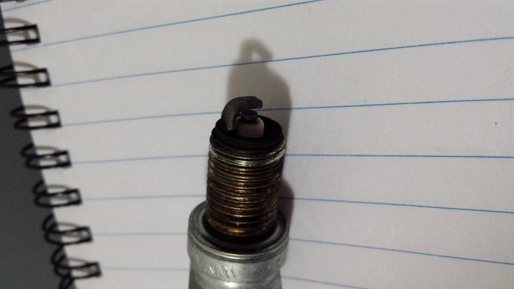

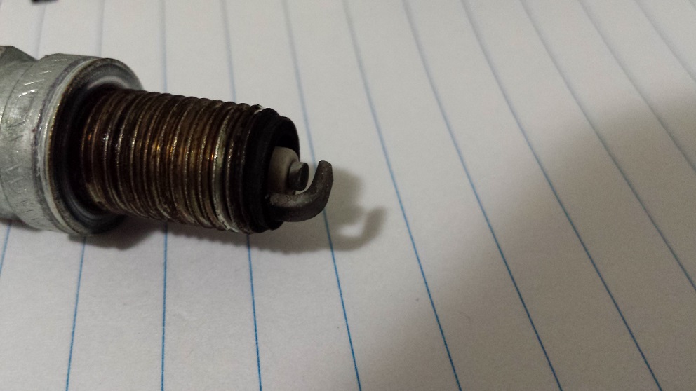

    Cheers for the replies, I have the short shots on coming up from melb. Will change to them once I have worked out a way to quiet them right down. I have attached a couple of photos from the rear spark plug, it looks black ans sooty on the thread near the gap, but the actual area where the spark jumps is grey, whats this tell me if anything? Stop riding till I get it tuned maybe? I just dunno want to blow up the engine in the first week of ownership.

    Hi,
    Look good
