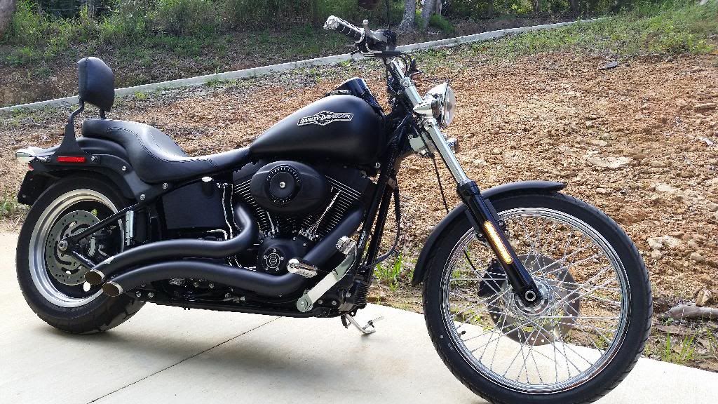

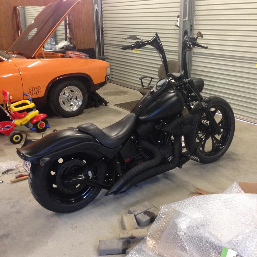

    The bolts that bolt ya rear pulley to the rim don't look black to me
  • Squid83
    Squid83
    Gotcha ando, my head was on the open primary pulleys after tju's question. Going to paint them when I pull the pulley to change to chain and sproket.
  • Ando
    Ando
    Don't get me wrong ya got a sweat looking sled
    Black out them bolts and some black floating rotors would set it off
    I am working on a blacked out Softy now with a few little tricks when done I will post up some picks
  • Squid83
    Squid83
    I've actually got a set off black floating roators on the shelf, I didnt put them on because the floating rotors only paint a small area black instead of all the way to the pad contact area, and upgainst that much black it really stands out.
    Defintely throw some pics up mate keen to see it

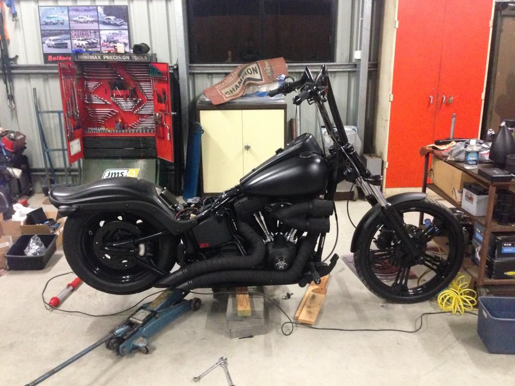

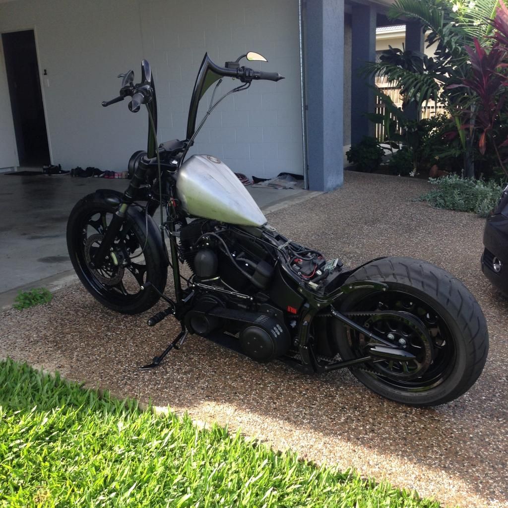

  • Squid83
    Squid83
    A sneak peak of the beginning of a full a make over

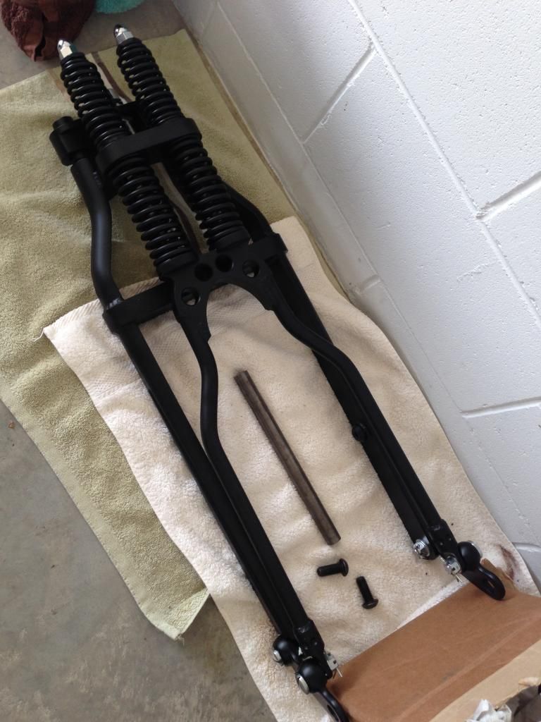

    [URL=http://s1286.photobucket.com/user/rayturner989/media/1E87AC42-73A1-4A98-8DC8-3E0B1DE44BF5_zpseniq8cnx.jpg.html][/URL][URL=http://s1286.photobucket.com/user/rayturner989/media/C7BCD3A9-F3FC-4103-8EAA-34BFB598A80D_zpsf9r4sa1h.jpg.html][/URL]
  • TJU
    TJU
    Gidday Squid ... looks like the beginning of a very interesting project ... have to ask , is that a Genuine HD Springer front end and if so what year is it ... looks nice and clean and lean ...
    the OEM front ends are bloody heavy compared to the telescopic ones ... don`t know if it helps or not but I worked out eventually why my front end has a bit of a buzz through the bars ...
    when I decided to change the standard top triple tree to a V.Twin brand one that allowed me a greater option of bar choices I didn`t realise that I would have to have the bars solid mounted
    if you know what I mean ... on most OEM top triple trees there is the space where the risers go that have the rubber mounts inside the triple tree ... the V.Twin one I went with does not so it
    is a straight bolt up solid metal to solid metal ... took me ages to realise it ... just thought that was what a Springer front end felt like , Lol .
    Of course if you stay with the Original Springer top triple tree you get to use the standard rubber mounts that should do away with the Buzz I get ... and this day and age there would be
    more choices for Springer bars I would imagine .
    Keep those pics coming ... hope your not getting to flooded out where you are ... pissing down here in Logan for our lovely Aussie Day Weekend ... Bloody Bosses weather .
    Tim .
  • Squid83
    Squid83
    Hey mate hope you are well.
    It's a custom made springer by the guys at Led Sled Customs. About 4.5" under stock. It doesn't have the rubber so I'll be enjoying that feeling through the bars! Lol

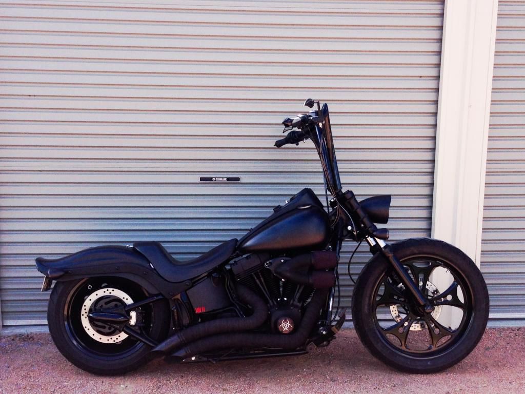

    Trial fitted the springer. I will be using different wheels
    [URL=http://s1286.photobucket.com/user/rayturner989/media/175FB802-1617-4459-A9CC-A5472EEE9D90_zps4yackccg.jpg.html][/URL]

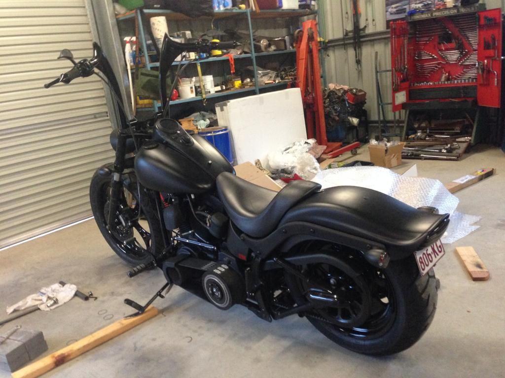

  • Squid83
    Squid83
    [URL=http://s1286.photobucket.com/user/rayturner989/media/454D2E5C-B2EE-468C-8D5A-A14FBCAEB221_zpsuybpej8w.jpg.html][/URL]
    Pissing off the frame horns to fit swing arm fender
    [URL=http://s1286.photobucket.com/user/rayturner989/media/04CA8AEB-97C5-4F3B-97CF-339BB24C46F4_zpsa3s37k72.jpg.html][/URL]
  • TJU
    TJU
    I reckon it`s a great look when the horns are removed but sure was a weird feeling when I saw mine being taken off ... I was like FARK , hope I am doing the right thing , Lol .
    Isn`t there a shit load of wiring on these bloody things ... I hate electrics ... keep up the good work Squid .
