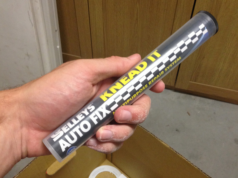

    1. First up, you need a couple tools - An Angle Grinder, Sander, Sand Paper, Masking Tape, a bucket of water, some torn off carboard or thin plastic, and some Selleys Auto Knead It Putty (used to fill the holes left over in the back of the top clamp once the speedo is chopped off).

    7. Once the clamp is all nice and dry, grab the Selleys Auto Putty and a relatively thick piece of carboard. The cardboard is used as a backbone for the holes in your clamp. You don't want your putty to fill the inside of your clamp, as your dummy lights still need to go here, so some torn off cardboard is a great way to just keep the putty from going too far into the clamp.
    8. Read the insructions in the Putty tube so you can understand how the putty works. Basically, all you have to do is cut a small piece (I took about 3 cm) of the putty off, and knead the putty with your fingers until the putty is one solid colour. Now you can apply it to the back of your clamp, and start filling the holes. The putty dries within a few minutes, but gives you more than enough time to work your putty around the back of the clamp. It's best to add a little extra putty as you can always sand away the excess. I filled up the two holes, and added about 2mm of putty covering the whole back of the clamp to allow for any holes in the roughly cut clamp to be filled and then later smoothed out with a sander and some sanding paper.

    Are you sure that 2mm of putty will be enough?

    Looks absolutely fine Allde. Just to be clear, it's about 2mm added to the back steel that's already there, so there's still a good 3-4mm of steel/cast iron backing that up. The putty is about 5mm thick where I filled the holes up, so it's as thick as the steel. :)
