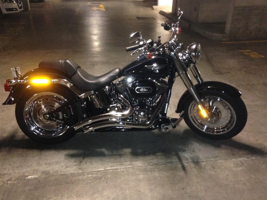

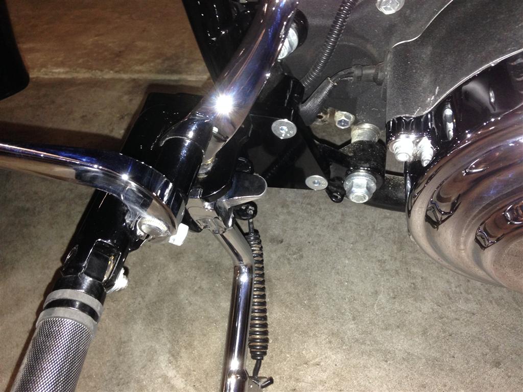

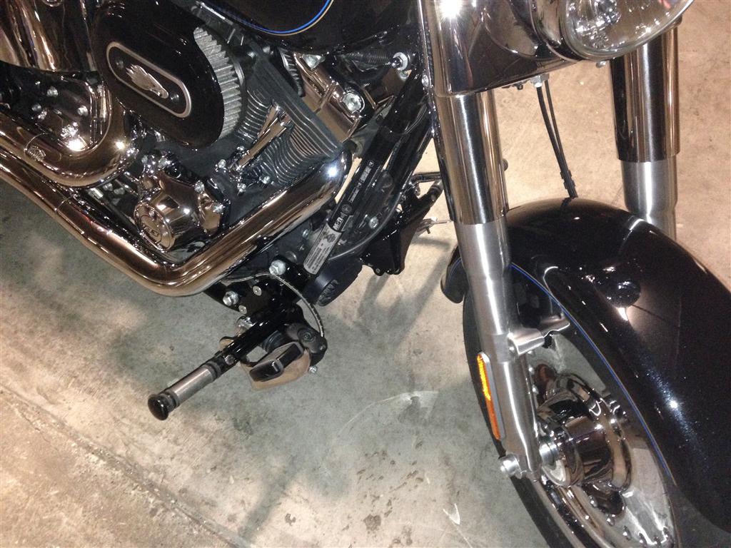

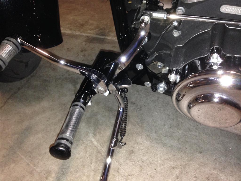

    I recommend for anyone who needs more leg room. some pics attached
