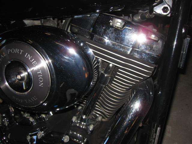

    Hi All,
    Gave the Iron it's first wash then hit it with Windex to finish off with.
    Whilst doing so, I though - what do we do to maintain the Engine parts which have been blacked out to prevent the white oxide which appears over time.
    I thought of using products like protectants which would result in a Satin finish.
    What are you guys doing??
    Fritzables.
