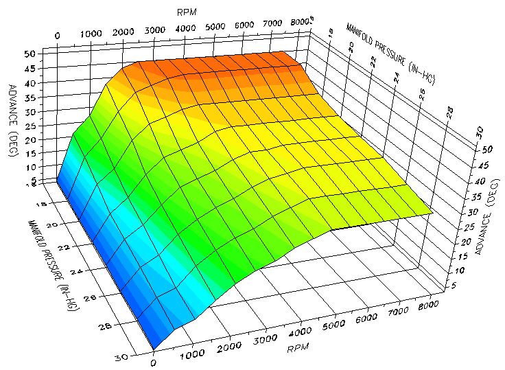

  • speedzter
    speedzter
    I didn't think it would handle that much timing. This is what 8,0 looks like.
    I'm running a 175 main at the momemt in the 95"/45mm Mik'
