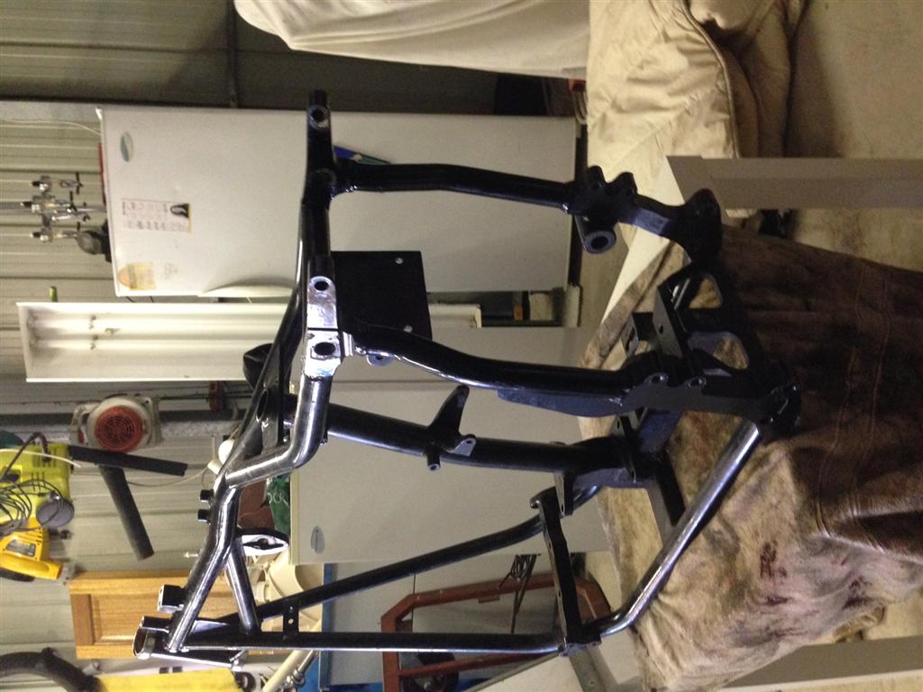

    I have just bought a Dyna frame off of a mate and i want to start building it but i cant work out what model it is, it has a engineering sticker on the frame and the Model number on it is 1986 FXNG could anyoine help me with identifying what these Letters mean for me?

    If it's 1986 it's not a Dyna. No such thing as an FXNG and the Nostalgia thing didn't show up until the did the Freisian Glide.

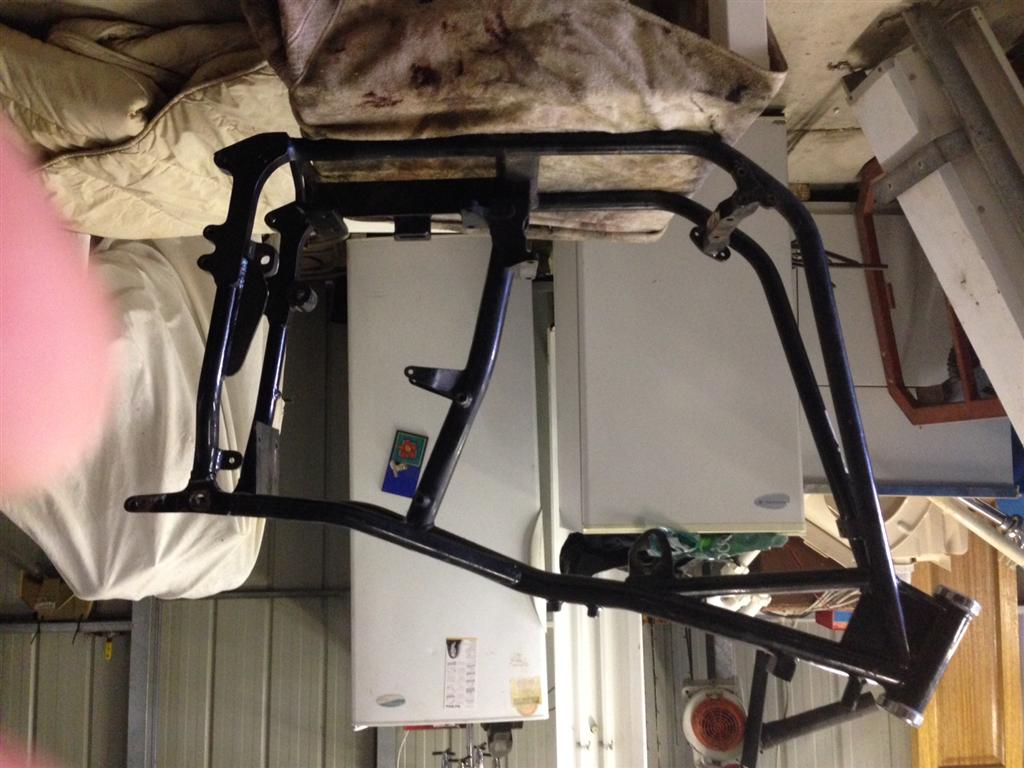

    Post a pic of the entire frame.
    Show us a photo of the whole frame

    Next question, will an Evo fit in it? There were 2 non FXR swingarm models in the change over period. A Wide Glide and the Fat Bob.
  • Neo Dutch
    Neo Dutch

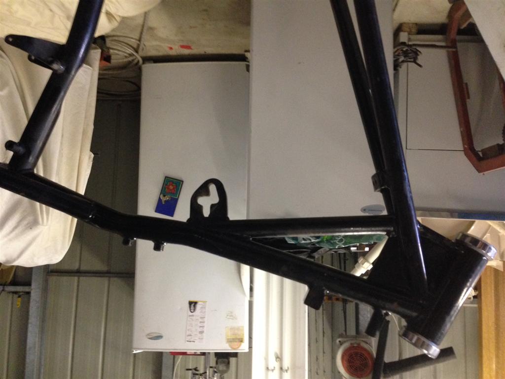

    Can we see a pic of the neck please?
    It's got Fat Bob tank mounts

    This is what my mate sent me with some relevant information of frame and what parts I got aswell..I am yet to see if the Evo engine fits but I am lead to believe it does. Well I hope it does as I already have one lined up for it.. More photos of frame to come very shortly..

    Dunright fx frame with new head stem bearings and a 4 degree rake. Frame has been engineered and cant register at any point so u domt need to take over regency.
  • Neo Dutch
    Neo Dutch
    Dunrite is/was a firm from the northside of Brisbane. They were a shop or two away from a custom shop owned by the Rebels.

    Not an HD frame. Refer to my post above.

    Ok now we have worked out it's not a genuine harley frame, the frame is a 1986 dyna fx frame made by dunrite and has larger diameter steel used for strenght and a 4 degree rake. Now stamped on the engineering sticker it says FXNG not FXWG!! Now i am guessing it has something to do with it being a custom frame and the NG stands for narrow glide as aposed to WG wide glide.

    Most likely a 1986 FXWG. Non-Dyna Wide Glide. Only '85 and '86 models came with evo engine, four speed and kickstarter with belt final drive.
    Dyna Wide Glides came much later. The good news is that this is a very desirable model. Your frame number should start with 1HD1BEL20GY.
