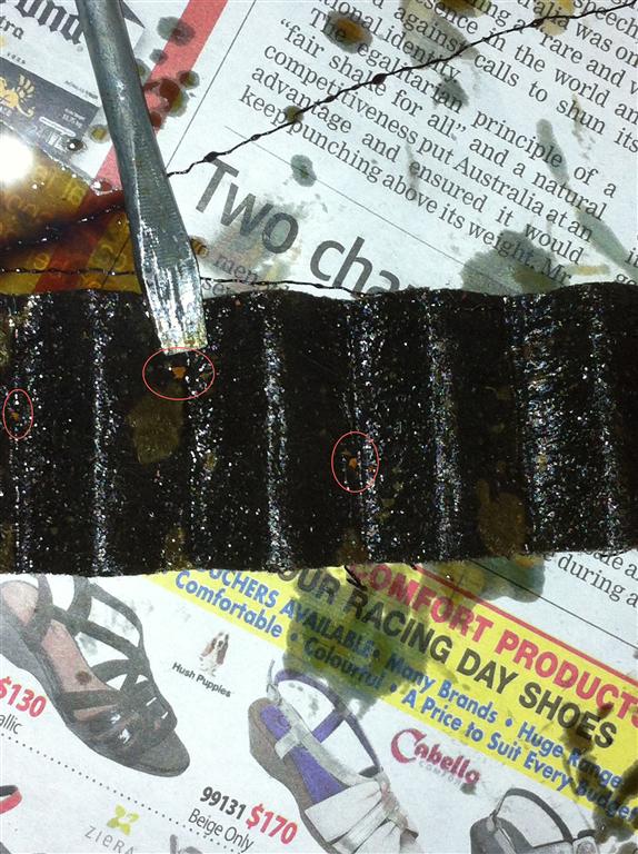

tore open oil filter
  • killerchef
    killerchef
    getting a cam upgrade & conversion to hydraulic tensioners done in about a week but had been planning on cutting this fucker open on next oil change.  glad im getting this sorted very soon.

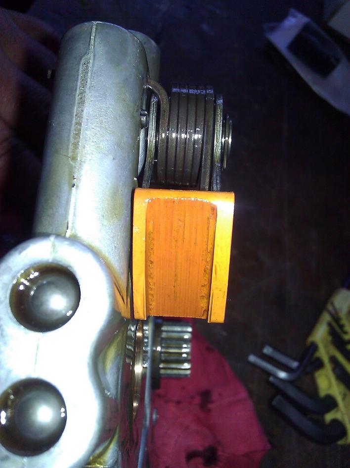

    tensioner upgrade complete & a set of andrews 37's in.   sounds very nice & pulls a bit harder too.  here is a pic ando took of one of my old tensioners when he did the upgrade for me.  some of the stuff i have read says that once they start pitting they really start to break up fast.  looks like just in time.
