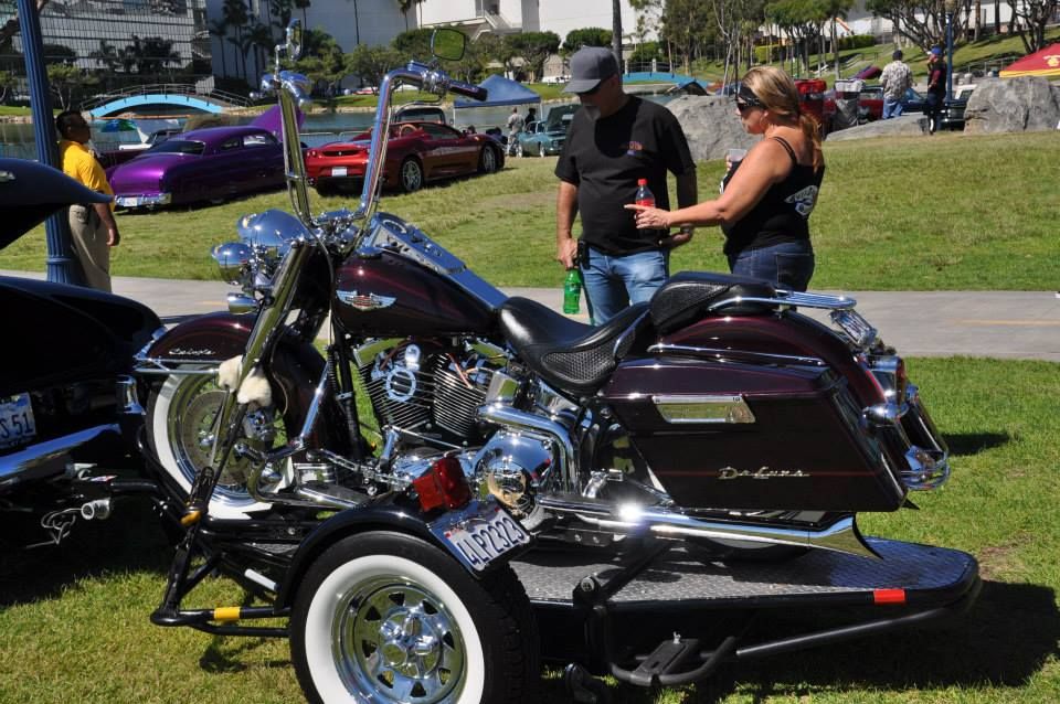

    Mine is a 7X4 with extended front over the draw bar, I use it for the Fatboy and the quad bike.

    With the front to stop the rocks etc; just need to cover front and angle backwards once above front bike wheel, and for rear you can have a beaver tail that bends down about 50mm at about 300mm in from the rear, the Ramp ( what ever you decide on ) attaches to the rear edge of the beaver tail, Thus making a gentle ramp to load / unload bike. But making sure the bike rear wheel sits on the Flat Floor section ( Not the Beaver Tail ).
    just my opinion.
