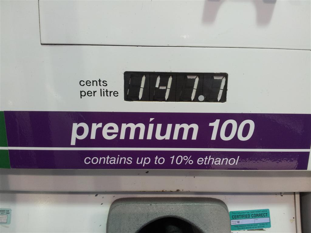

    I'm not sure but the fuel might be different, they are imperial and we are metric. So the numbers you see the fuel rated at or calculated at might not be the same. Some people were trying to get the fuel we have changed and the base fuel to become what we call 98 or at present premium (PULP). Might be why they (USA) complain about the ethanol blend being rubbish, but here one of them is 100 rated which is a bit higher than our premium of 98. Jap import cars sometimes need the timing changed to suit our fuel as well so they don't ping which would mean our fuel is lower than Japan's as well.
  • Captain Hook
    Captain Hook
    USA fuel is rated by AKI (anti knock index). Australia it is done by RON (research octane number). So its a different set of numbers for the same fuel in each country. There are other rating systems as well so it can be confusing, apples and oranges, the numbers are not comparable easily.
