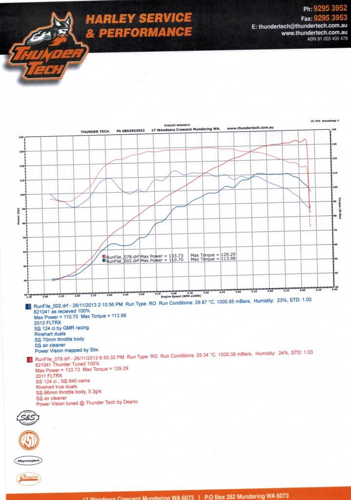

    FYO has asked me to post this up, pretty impressive

    fark that tune made a difference, well worth the effort and money.
    do you know what CP it is at?
    what pipe?
    torque seems to take a while before it jumps.
    Now at least I have one on an Aussie dyno to compare to.
    Thanks for posting

    Appears to be big differences between Deano's Dyno and Stix's PV runs, I know Stix is a pretty experienced bloke, is the PV hard to configure?
  • Lushy
    Lushy
    Deano does a good job. I would say he is pretty much on the money with that one. I see similar numbers although have not done one with a 70mm TB. Mid 130's with a carb is quite doable, but jeez they use some fuel :-)
