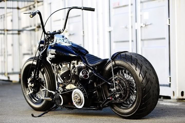

    The pic below is something how mine might end up looking ... this is another bike built by Shane ... mine will have different pipes ... wheels ... bars ... and of course different paint scheme but gives you a idea as to the style i am going for ... for now thats it ... just have to hope Crazy Cambel Hitler dosen`t get to much more out of control and ban bikes alltogether ... Cheers all ... Tim .

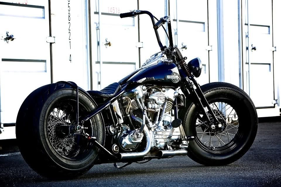

    This is the look I want to aim for
    Good luck with the build mate

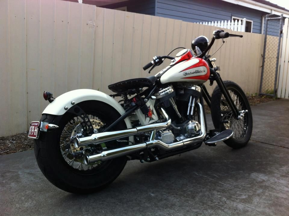

    Carl at Gasolina here in Melb makes a cool Number Plate frame the he uses with that fender
