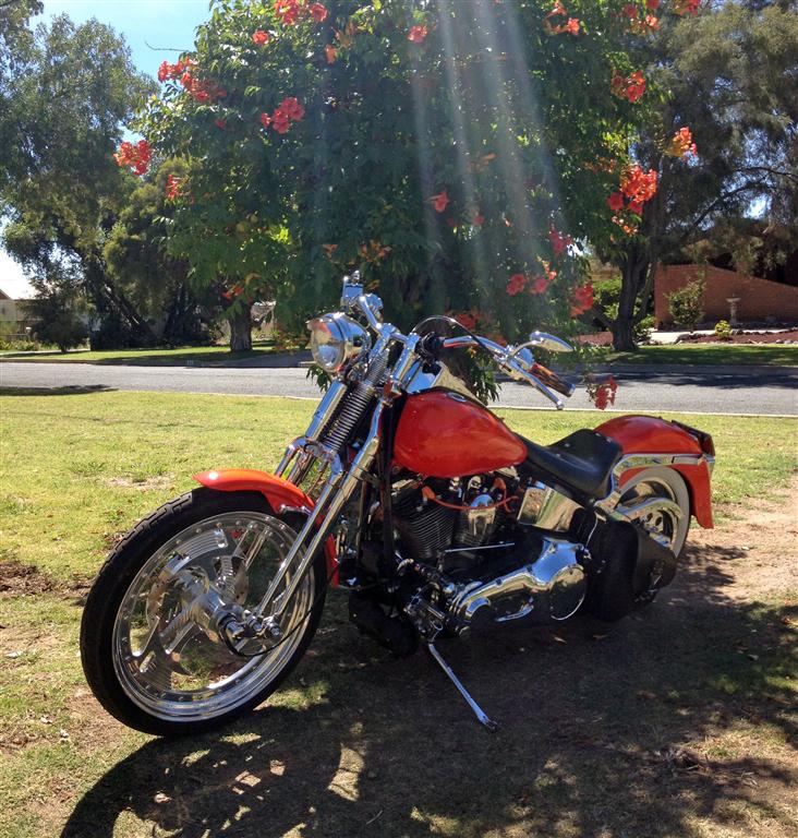

    Cheers Tim , I'm still chasing bits myself so my springer still looks the same but heres a pic anyway. pretty happy with this one lol.
    Still chasing some dogbone risers with NO RUBBERS and no luck with a 21 inch spoked wheel for the front to suit a springer cheep enough. Looking at maybe lacing up a new one which will give me the option of putting a colour on the rim, so if anyone can point me in the righ direction, don't be shy.
