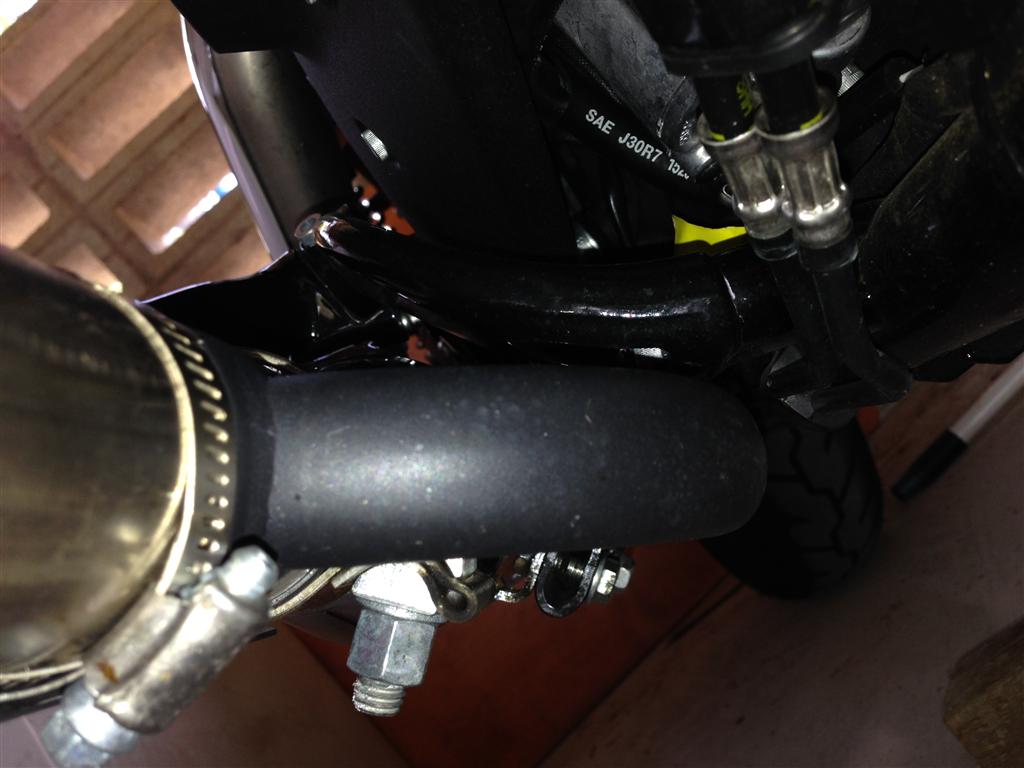

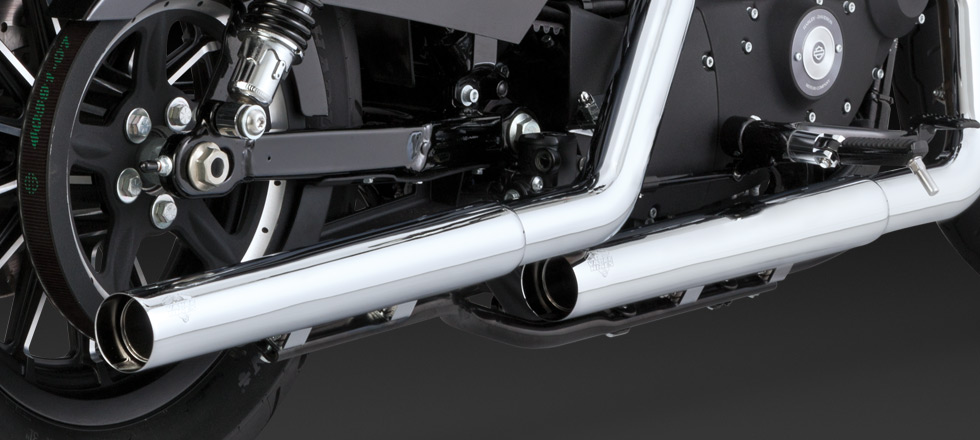

    Like in the title Im after some slip-ons, really like the look of the straightshots HS but  have noticed the exhaust are different from the previous year 2013. The 2014 exhaust has the crossflow pipe welded(yep had to double check) the the header pipes just infront of where the stock exhaust is clamped.

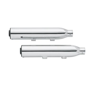

    These look like they are the only ones available..... in the States. $419.us wonder how much they will cost here when available.
    Harley-Davidson® Screamin' Eagle® Mufflers - Street Cannon Slip-On - Sportster® Shorty Dual - 64900208
    Also noted:-
    Fits ’14 XL models. Installation requires separate purchase of End Caps and Muffler Clamps (P/N 65296-95A; Qty. 2). $119. us LOL

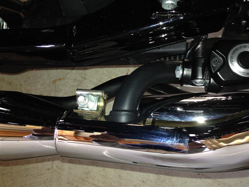

    Added  pics for clarification. Also read on the U.S site that the  ABS gets in the way of  the exhaust. They may have moved the rear brake master cylinder but I can't see why it would affect  placement  of the slip ons.
    Can anyone else elaborate on this who has more in-depth knowledge of sportster exhausts?

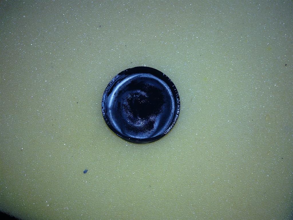

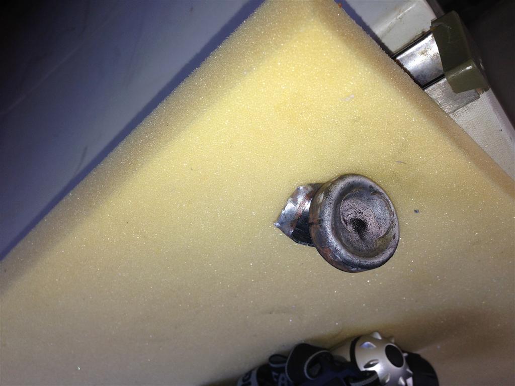

    Well got bored today and took the mufflers off. Couple hard bangs and well a 30mm plug popped out lol pretty sure they were 'tacked' in but the came out pretty easy.
    Guess I dont need staight shots anymore lol.  Honestly it has a bit too much bark when you crack it, might look for some quiet baffles to smooth it out :)

    Good one mate. Great conversation you have been having with yourself on this thread! I have been watching with interest anyway. Too late now, and sorry I did not post this earlier, but you could have drilled the plugs you have bashed out using an extension piece and a step drill (available form any local Bunnings). I did this to mine (2010 model) and was able to steadily increase the size of the drilled hole until it was sounding good but not too loud. 14mm did the trick. Full points for keenness and impatience champ.  Cheers, TC

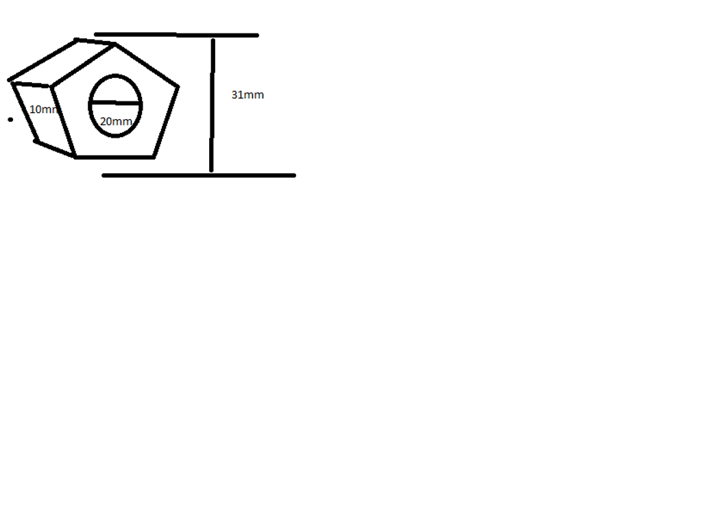

    Well went to bunnings and picked up 2 'nuts' and fashioned 2 'plugs' ,  hammered them 23cm deep into each pipe from the rear . The 'plugs' have a center diameter of 20mm.
    This gave the exhaust a nicer rumble at idle and when cracking the throttle the bark is not as harsh. decibel reading from iphone app was 87dB at high idle and 95-100 dB when cracked. Would most likely be more under load.

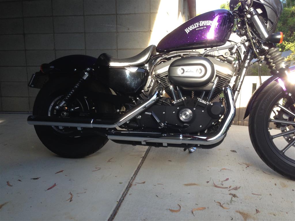

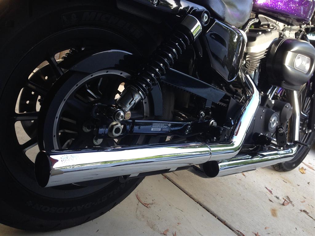

    Well the Slip-ons finally arrived yesterday and were promptly installed. A ride to work this morning was, lets just say, a loud one  smiley Even with ear plugs you could 'feel'  the  pulses coming from the exhaust. The quiet baffles are on the  way along with the SE stage 1  air cleaner so hopefully they will arrive this arvo. If not I will put the stockies back on as now I'm just a big loud magnet to the local constabulary, and any more attention will probably not be a good  one.
