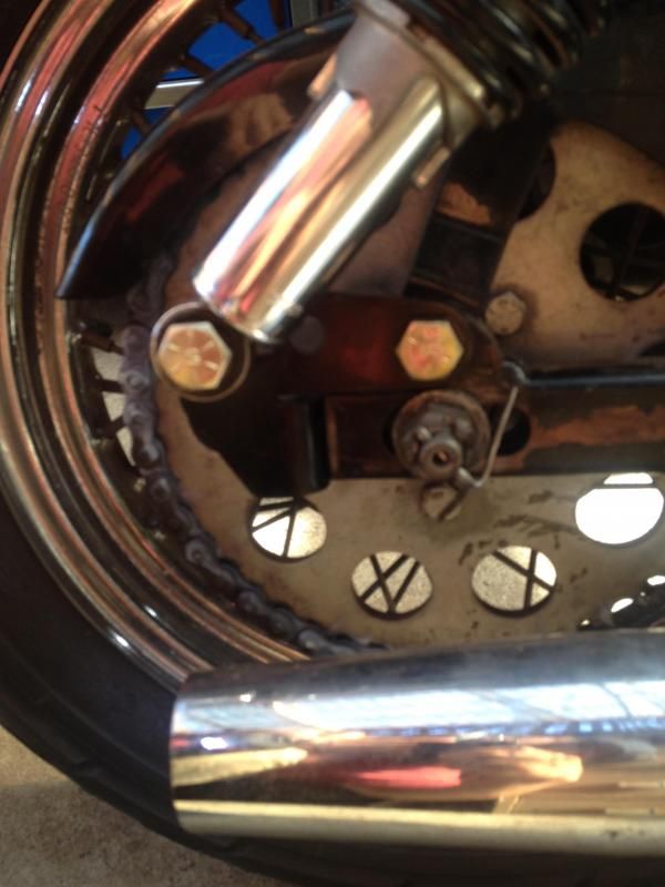

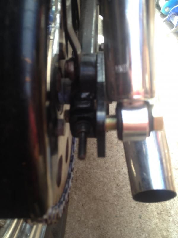

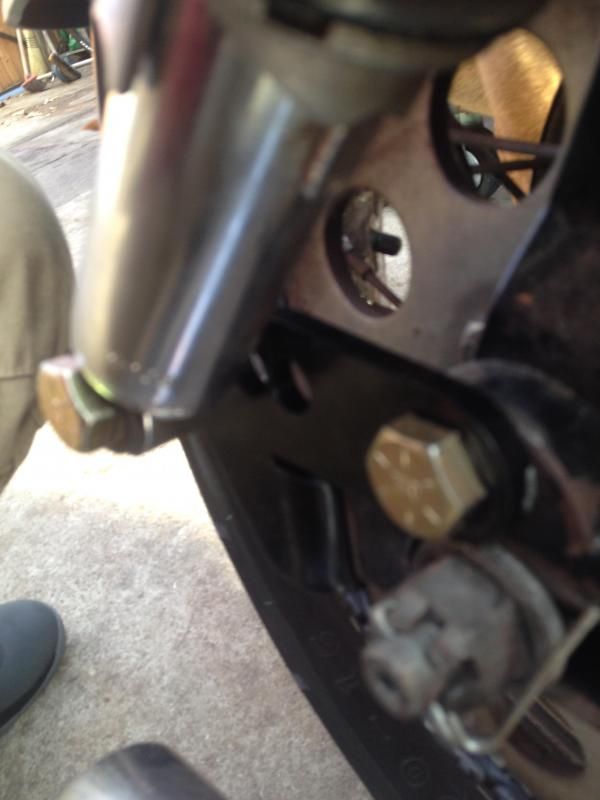

    Problem im having with mine. Brackets fouls on the shock housing, needs spacers? Seller doesnt know whats going on.
  • judgelj
    judgelj
    Is the shock maybe wrong?
  • Burnzi
    Burnzi

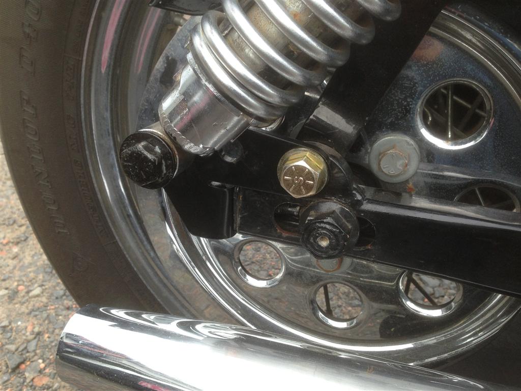

    Shock does appear wrong, if you look at my pics the bolt housing is the same width as the shock body whereas yours is narrower than the shock body. Original shocks? And yes it looks like a spacer is needed
  • judgelj
    judgelj
    Ok that makes a lot of sense. So they appear to be different stocks. They are Koni, im assuming these are aftermarket?
  • Burnzi
    Burnzi
    Not sure about the Koni being OEM or not, hopefully someone that speaks Sportster can chime in on that one......anyone?
  • TC883
    TC883
    Koni are not OEM. They are aftermarket. I am not an expert on this, but I think this may be the problem, as the aftermarket shocks are sold with one model possibly having multiple applications on different bikes. Works fine stock, but not with the lowering blocks...spacers are the go. TC

    Would anyone have a pic of the stock shocks?
