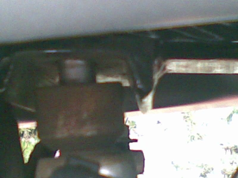

    during the week i was fitting more bits to the bike and with the use of the bike lift have better access. Well, what did I spy................ seems that the nut has dissapeared from the right side of the engine stabiliser mount. This would also account for the metal rattle sound I have not been able to eliminate.
    The bolt is fairly worn, especially the threads. Bike is now back with Frasers....... they said I should have it back by next Friday after they check for any other damage when they replace the nut/bolt...
    Pic is poor, but gives you an idea.... you can se the gap between the top of the mount which bolts to the frame and the spacer (item 16 in the pic at the bottom)

    picked the bike up today.... all I can say is what a difference a bolt makes
    behaving much better... rides almost true... no ringing sound...
