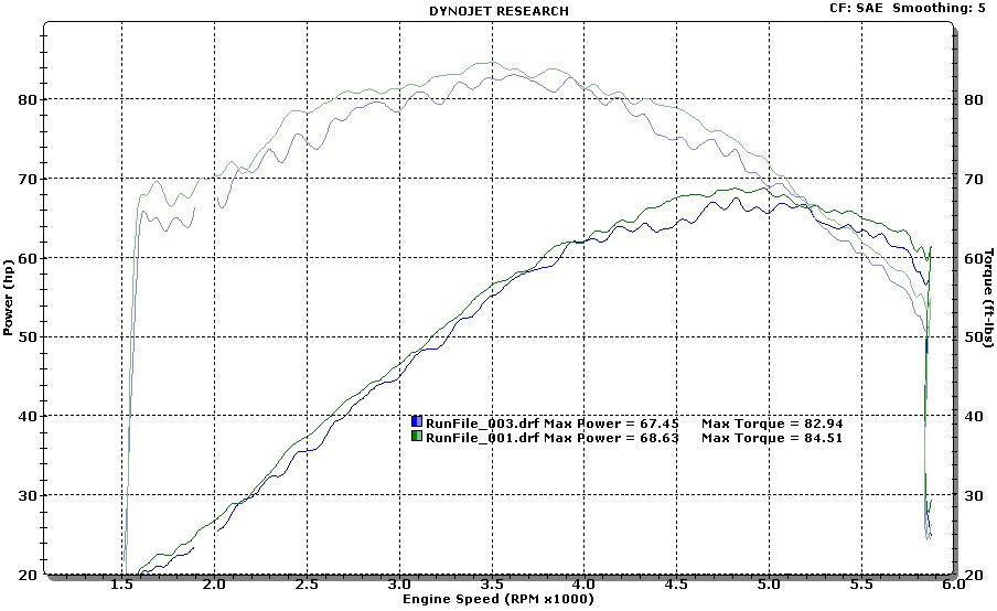

    2014 Water cooled 103 ALL STOCK with 180 miles on the clock. While not completely broke in, it is what it is.
    Compared to a 2013 std bike is it better or worse or the same?
  • Steve Cole
    Steve Cole
    Hp about the same, torque is higher than what we normally see on a 103. It sure ain't 10% better like I hear they claim!
  • Steve Cole
    Steve Cole
    I hope that this bike comes back after they get some more miles on it, so we can do another set of dyno pulls. What I showed was the highest and lowest of the pulls we made. While I am not really impressed with what I saw, I still hold out a little hope that the numbers come up some after it gets more miles on it. Now, I'm not holding my breath but am willing to see what it does down the road. The problem is I cannot be assured they will bring it back by again. Will will be running more of the new engine in the near future so we will see how they begin to fall in line a month or two down the road.

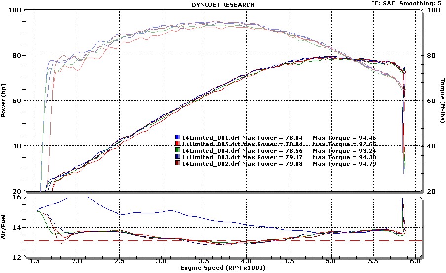

    This is our in house test bike with 1700 miles on it. ALL STOCK with AFR taken from exit of FRONT exhaust port.

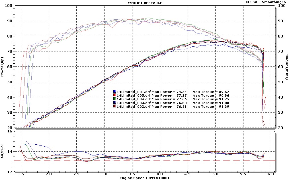

    This is our in house test bike with 1700 miles on it. ALL STOCK with AFR taken from exit of REAR exhaust port.
  • robots
    robots
    Hi,
    How's the AFR readings, so much for Harley's come lean from the factory you better add a tuner to lower AFR otherwise gonna blow a piston through motor
    Will be interesting to see next one with air intake change and exhaust change
    Thanks
    Robots

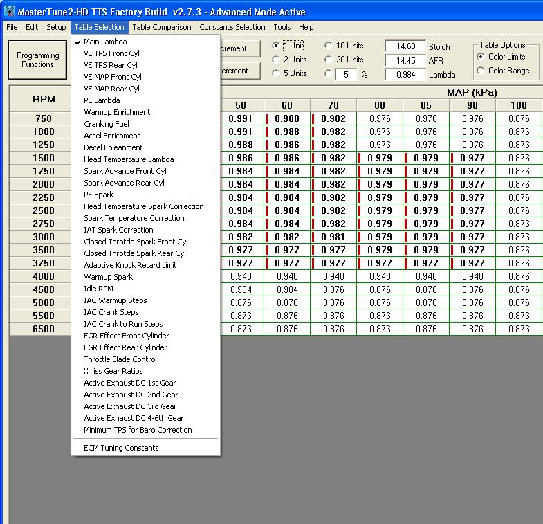

    Limited 2014 software update is now released. This will allow for programming and testing of all 2014 HD bikes EXCEPT Touring models. The Touring models were held back since we donot yet have the base calibrations finished. This means you can work on all the rest of them now. Also HD has seen fit to change the wiring on the Data Link Connector on the Touring model ONLY. This requires a new cable interface kit for the 2014 Touring models only. It is in stock at our dealer now and can be ordered if needed. As the Touring model air cooled and water cooled calibrations get completed we will add and update for them.
  • Steve Cole
    Steve Cole

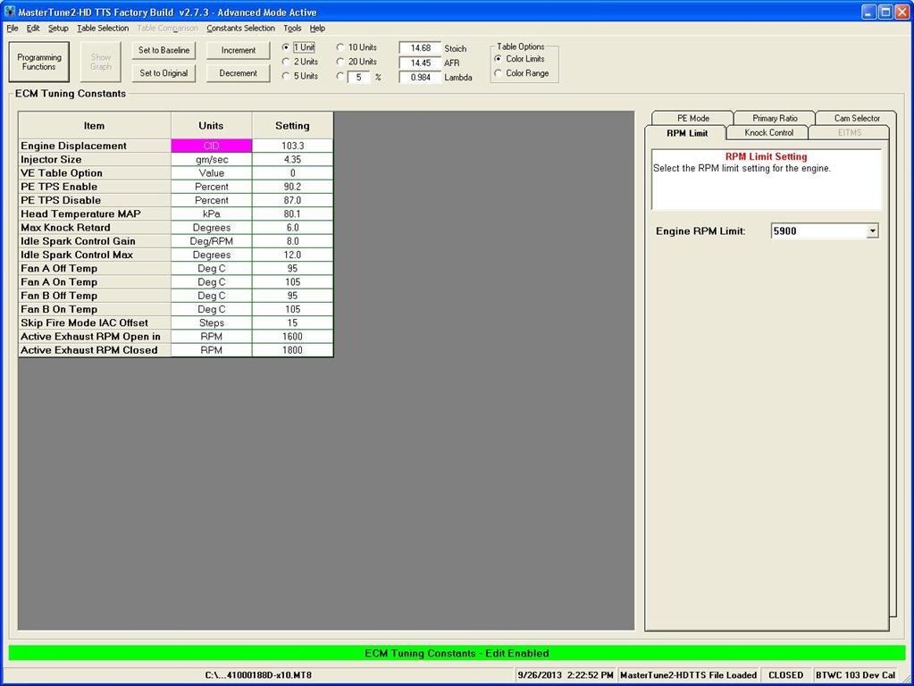

    Made good progress this week and Beta Software is going to Beta testers for the 2014 Touring bikes now. Here is a sneak preview of whats coming. 103 base calibrations are being finished up both air and water cooled and CVO 110 are for next week.
    Plenty of new tuning items for the tuners to do there jobs. The Active exhaust features are only for HDI calibrations as it's not used in the USA.
