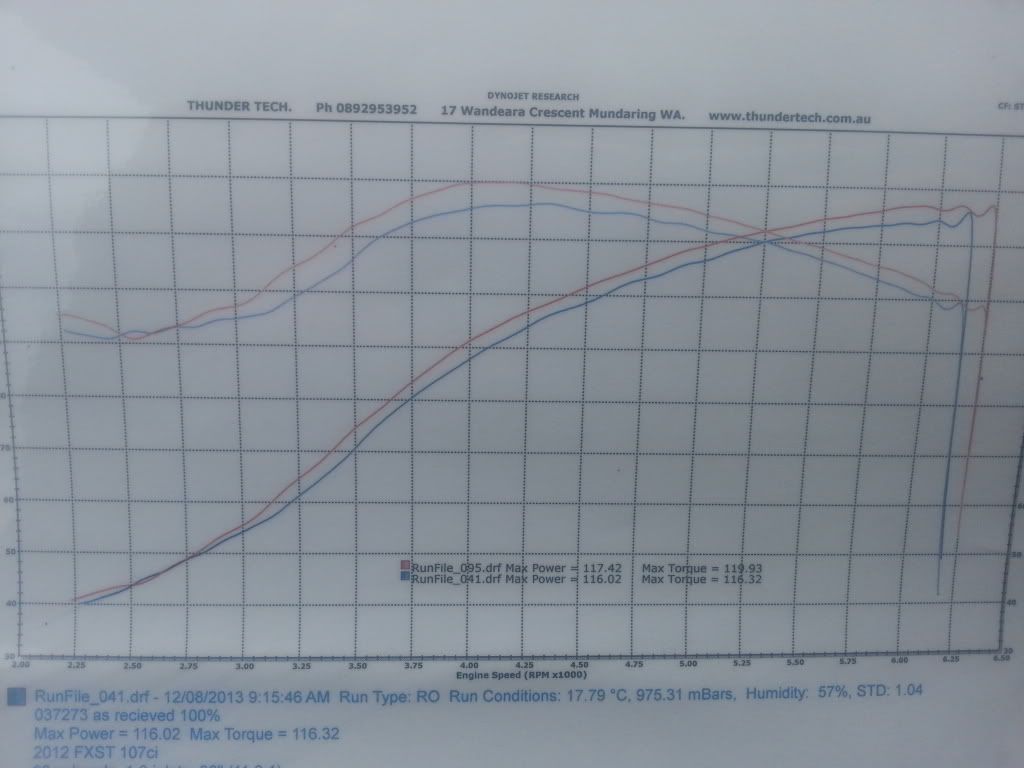

  • nnk12
    nnk12
    Thats one of the best stage 4s ive seen around heres a pic of my 107 tuned at the same place 117 /119
