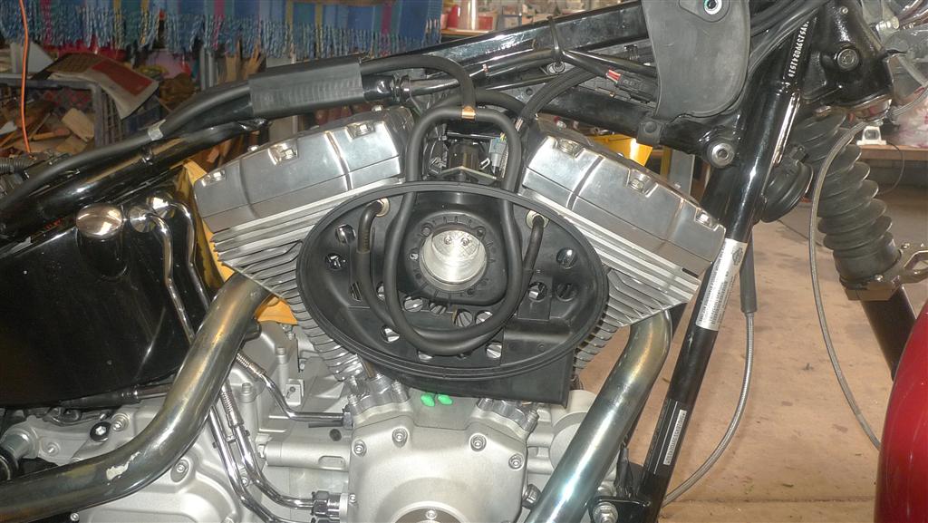

    couple I have done
    [URL=http://s307.photobucket.com/user/Ando1450/media/P4260014.jpg.html][/URL]
    [URL=http://s307.photobucket.com/user/Ando1450/media/P7300590.jpg.html][/URL]

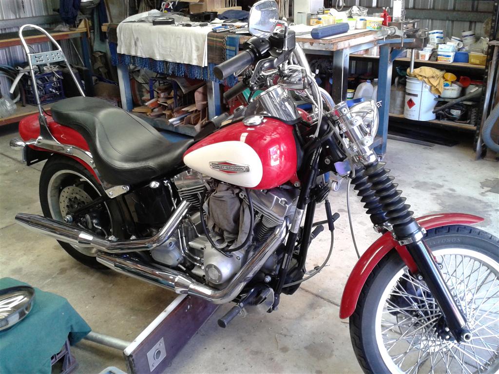

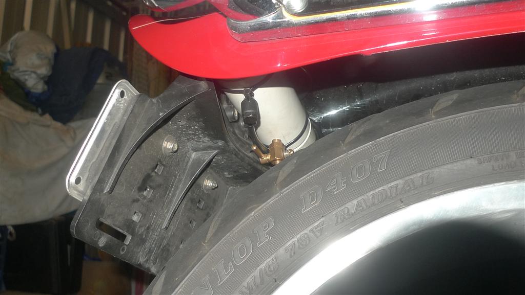

  • paulsails01
    paulsails01
    May be somebody can gleen an idea from what I did from the pic's, just wished I had taken a pic of the crud on top of my piston crown's that propelled me into action.
