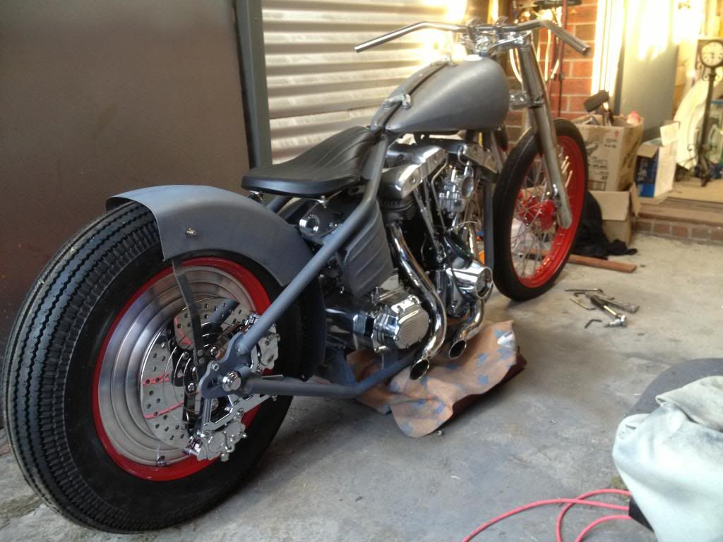

    Booker T & The Mg`s ... Green Onions ... Very Cool Music for a Very Cool Bike .

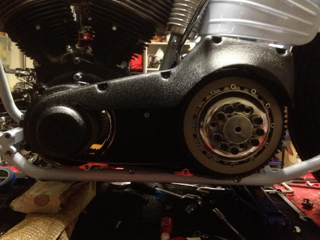

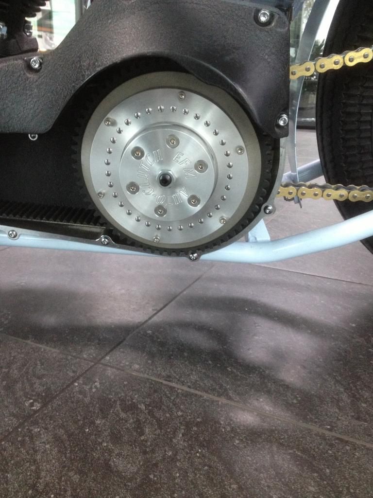

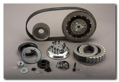

    How naturally did the foot clutch and hand shift come to ya .
    Tim .
    To be honest Tim not to good, I've riden bike with them before with no trouble, riding it and changing gears once going is no problem .
    The problem is taking off . With the BDL Belt drive the Clutch Springs are to heavy , Standard it came with 9 Springs and I dropped it down to 6, it was a lot better but I was finding really hard to control , it was trowing my foot off the Leaver, so I have just fitted a EMF Auto Clutch and it is awesome to ride now , the EMF is a centrifugal set up that still uses the BDL Clutch packs and is set up to take off around 600 rpm, you can roll off the throttle and up or down shift without a clutch , I still have the foot set up but I don't have to use it if I don't want to, the best part is when I stop I can just put both feet on the ground without having to worry,,,

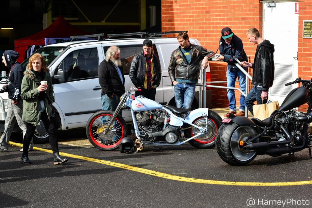

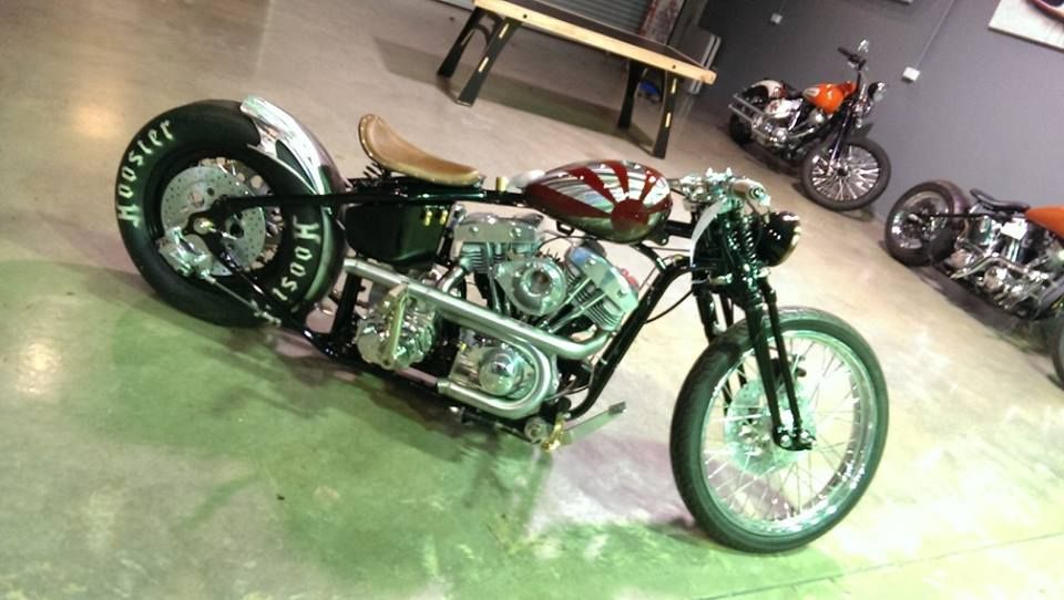

    Greazefest last weekend
    [URL=http://s258.photobucket.com/user/raced86/media/photo_zps232ed69e.jpg.html][/URL]

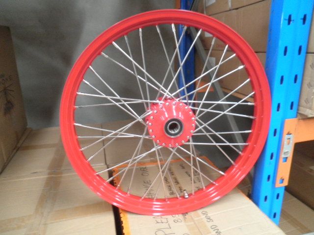

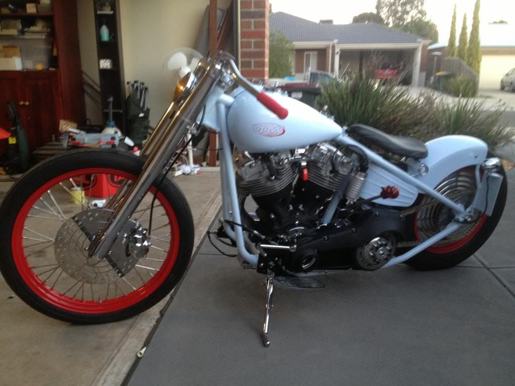

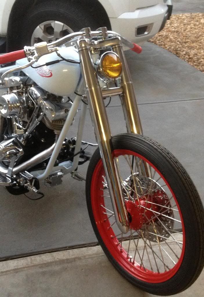

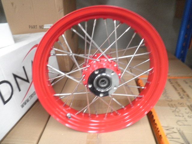

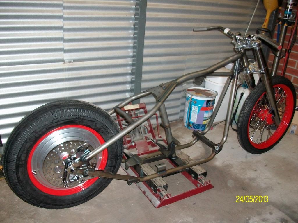

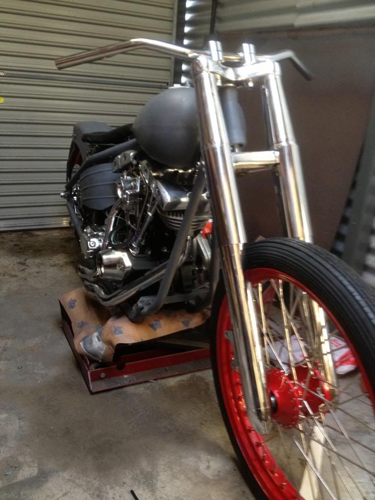

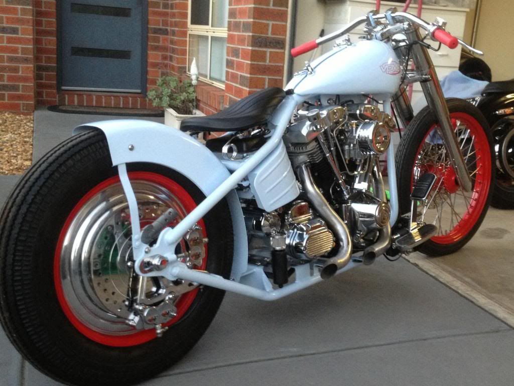

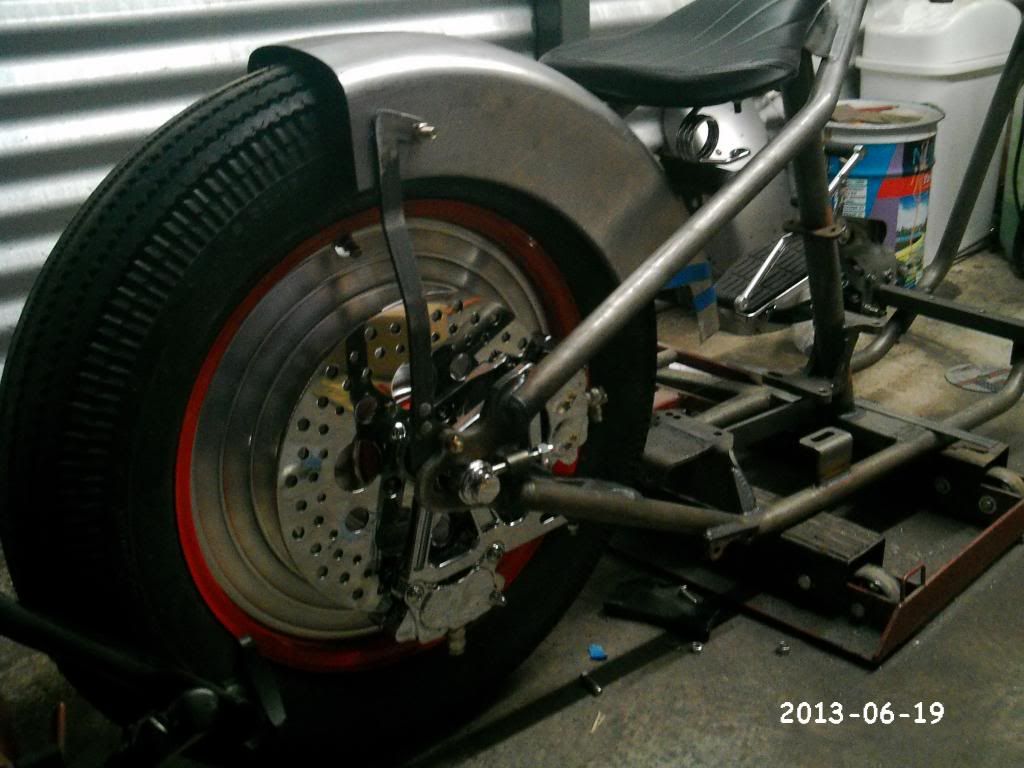

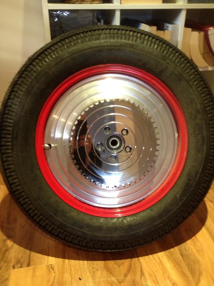

    G'day Walka, awesome build man, the bike looks beautiful. What size were the wheels and tyres that you used ??
    9 years ago
    The rear is a 16 x 3 with a shinko E270. 5.00 x 16 and the front is a Avon speed master on a 21 x 2.15 rim
