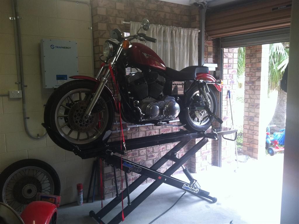

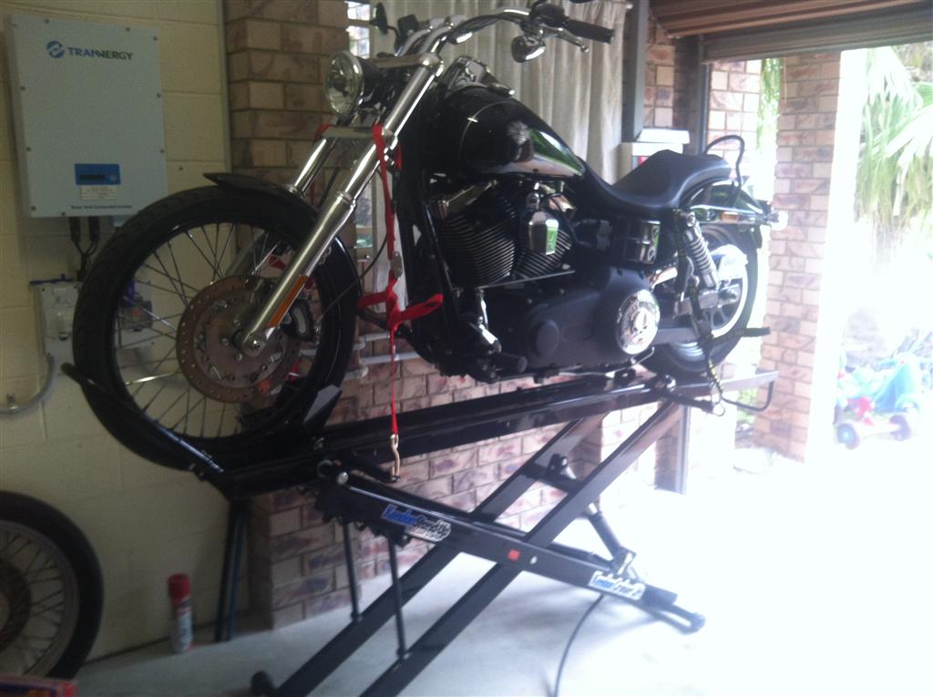

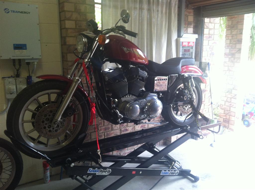

    Sporty at full height
    Sporty at full height: rear wheel on the main section of the lift ie extension not needed

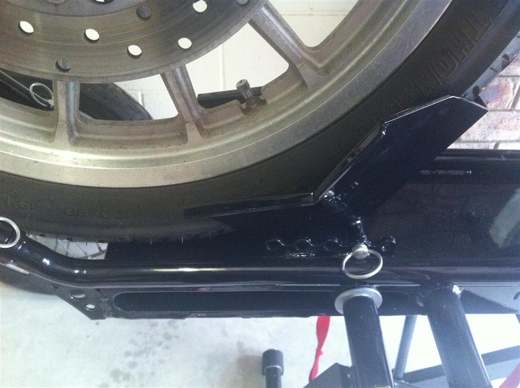

    Sporty in front wheel chock. 5 settings I second last is cool for the sporty but maybe the middle one for the WG?? Still need to experiment

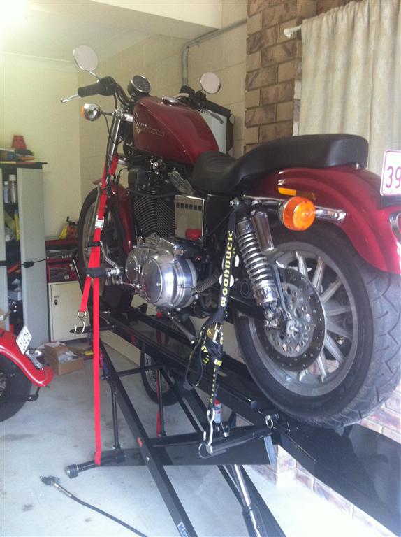

    Sporty on the lowest height setting
    Sporty minimum height; compressor hose underneath lift still freaks me out but does not fowl. I'll try and find a better route for the hose

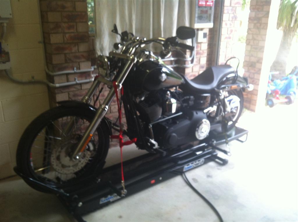

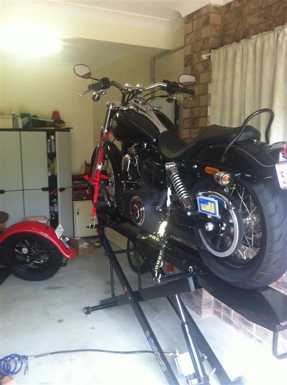

    WG loaded: Wheel chock on 2 last setting, maybe middle setting will secure front wheel better?? Wouldnt leave the long heavy bike unattended without the ties

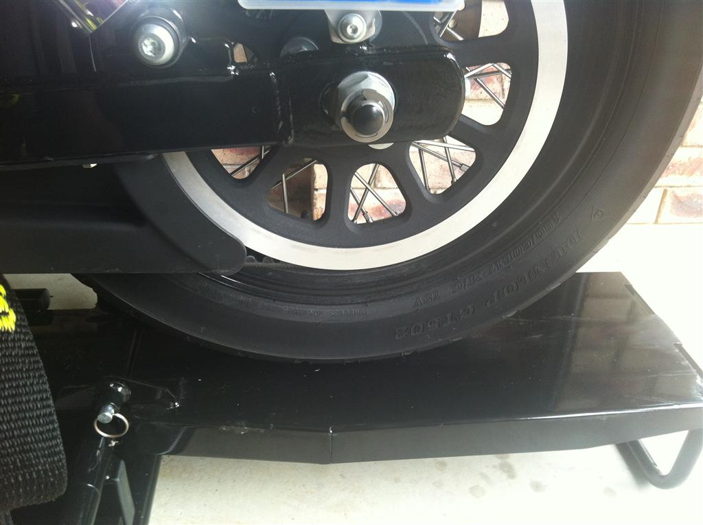

    WG rear wheel on rear extension
    Lift at maximum height with WG - Thumbs up
    Maximum lift: Notice long RAM and pump

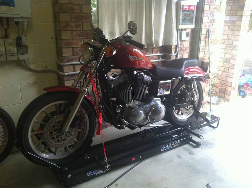

    Lift at minimum lift

    Don't know much about physics but the width of the legs don't look to be wide enough to support the bike and stand at its maximum height
    it looks as though it would be a bit wonky if you bumped into it.

    Great write up mate! Thanks. How stirdy at full height would it be?

     already see one problem with it, doesnt have much table space to lie down tools especially when draining oils where the fuck ya ment to put a drain bucket without knocking the thing off and spilling oil all over the place?
    you would be luck to sit a stubby on there safely

    Ok ok you guys caught me out!!!! The bikes on the lift are actually cardboard cut-outs and not my bikes - wouldn't risk my own bikes would I?????
    The lift is long and I agree from the photos the legs appear to be narrow so I took some measurements on the feet and on the tie down points for all you sceptics!
    Front supports: 580mm (outside to outside)
    Front tie down: 520mm (minimum dimension)
    Rear support: 580mm (outside to outside)
    Rear tie down: 620mm (minimum dimension)
    Max lift height 810mm
    I have checked out the “cheap” imports and although they have a table – they are “wonky” because of the amount of play in the support frame. The width of the table doesn’t add any stability IMO. The tie down points on the table lift table would be in the same order as those mentioned above. As for the front chock I still have to play around with the settings for my wide glide but I’ll get it to work. I definitely prefer the wheel chock over the front wheel “clamp” on the cheaper models
    My lift is stable as! Would I leave any of my bikes without ties – Never !!! I only have pull-type ties which I'll replace with rachet-type ties.

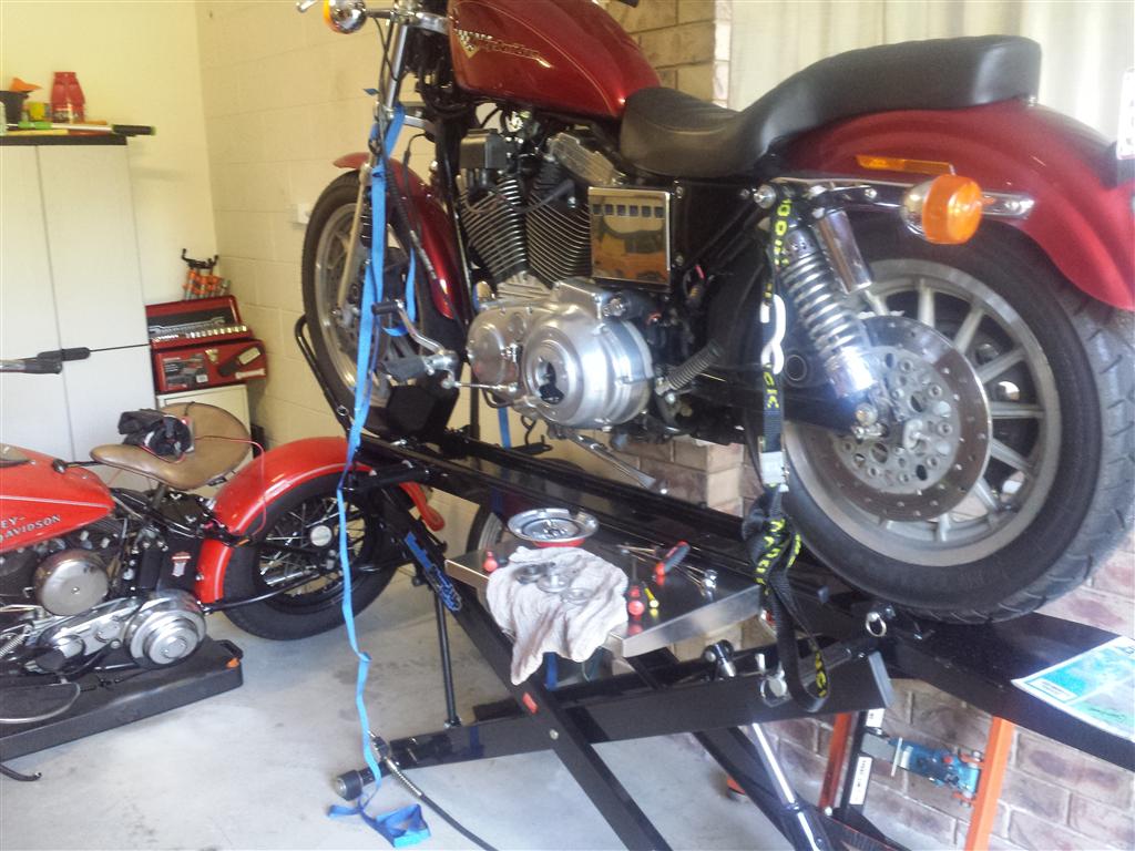

    Its been a while since I first reviewed the kendon bike lift, I've used it a few times since and still happy as.
    I found that the front tyres choke actually works quite well once you have set it up correct -  middle notch is what I found best for the sporty and wide glide
    Used the jack - brilliant for servicing the front and rear wheels!
    Used the trays - see photo - only 18" wide but enough to put down a few tools. You cant put 2 - 18" trays next to one another which is why I would have preferred the 36" wide tray but the supplier didnt have stock when I ordered - still with 18" on both sides is enough to tackle most jobs without break the back ;-)
