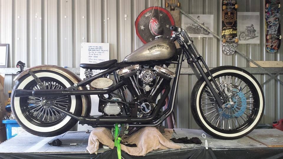

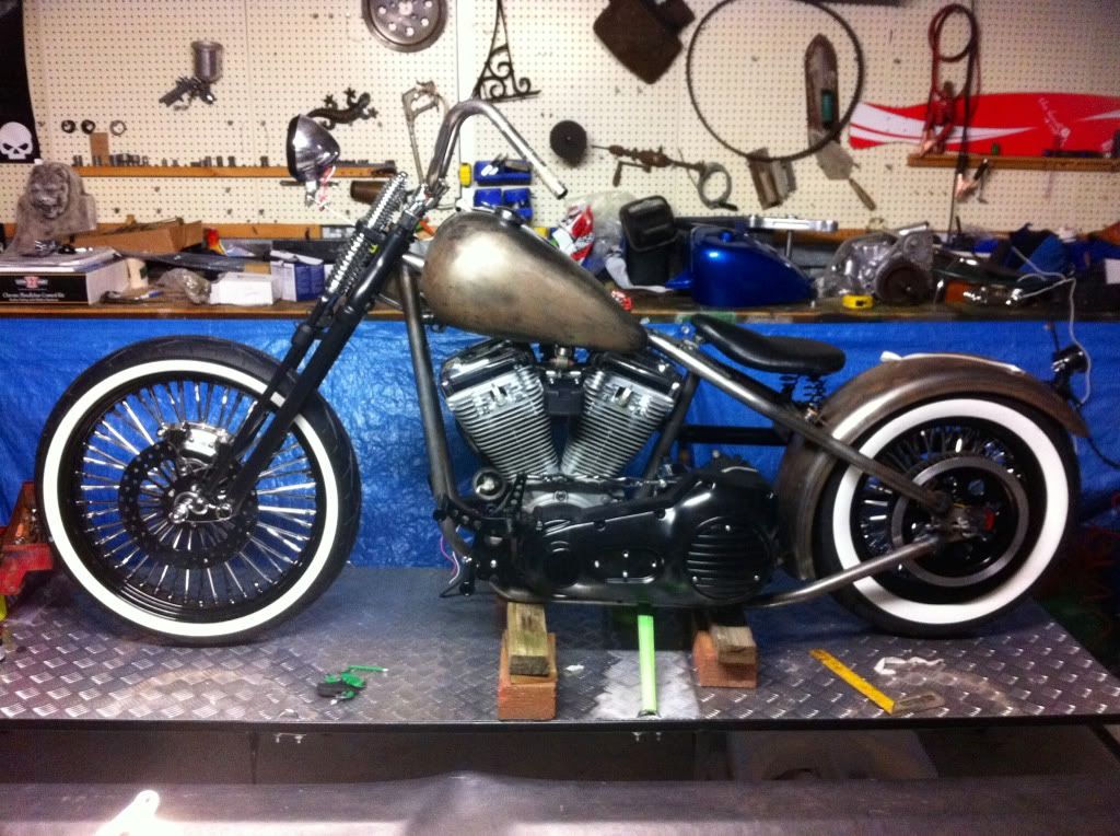

    Sensational.....keen to see the final build mate,

    Great lines....love it...

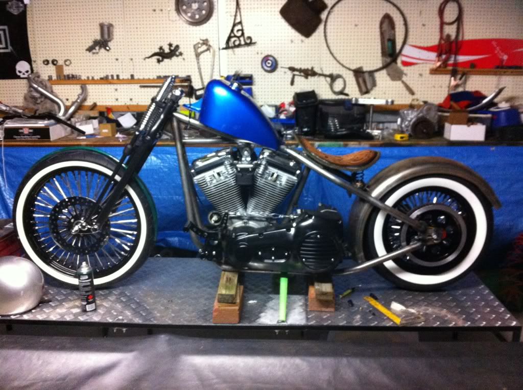

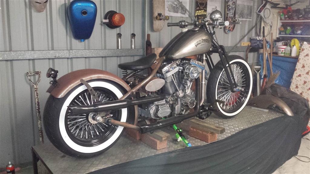

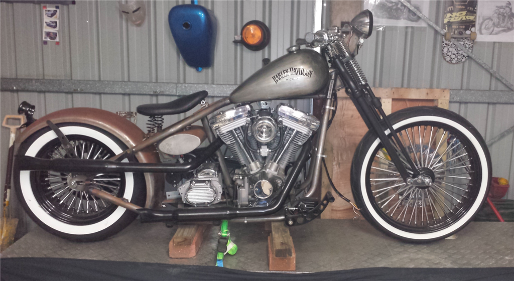

    Gidday Brick ... Bloody great job so far ... just a curious question , the rear guard , is it in it`s final position ...
    Tim .
  • Neo Dutch
    Neo Dutch
    Hope not. It certainly needs tightening up of the radius.

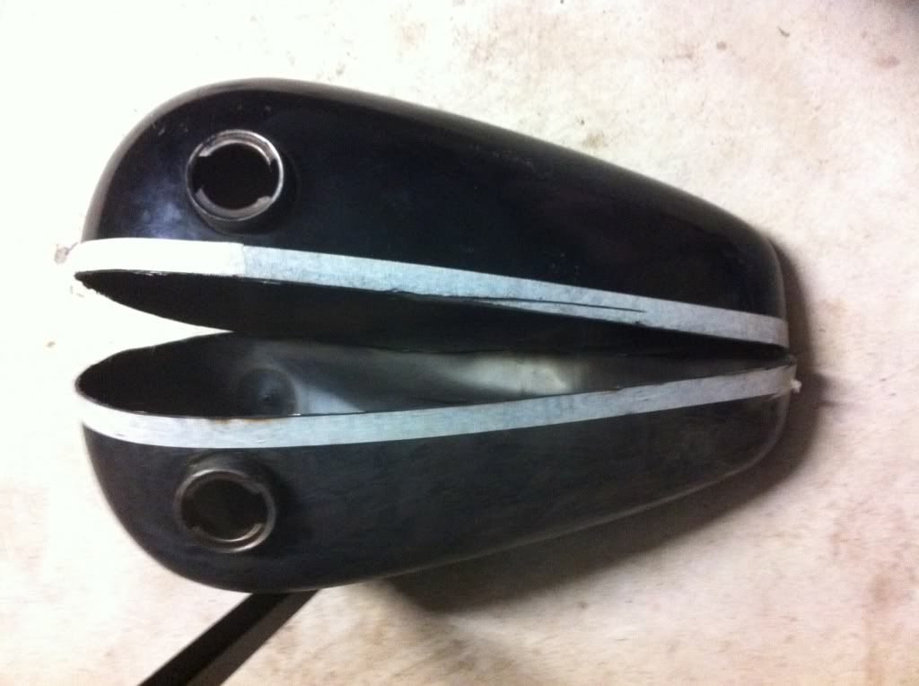

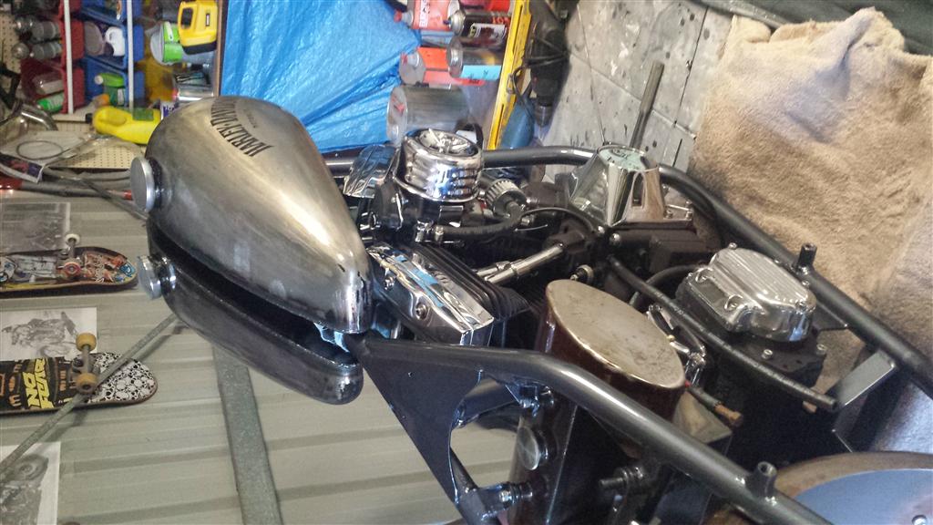

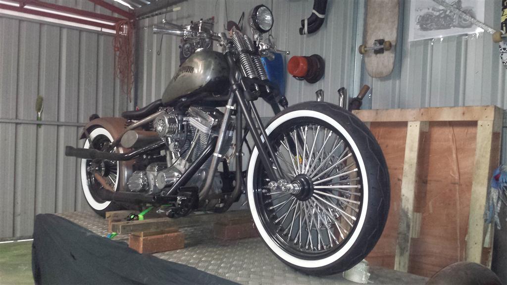

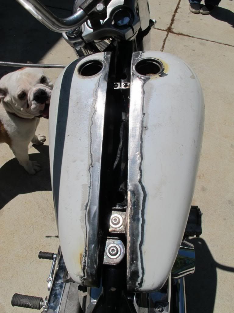

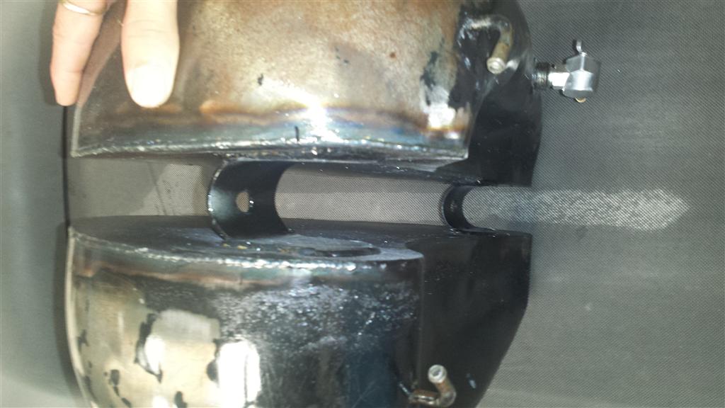

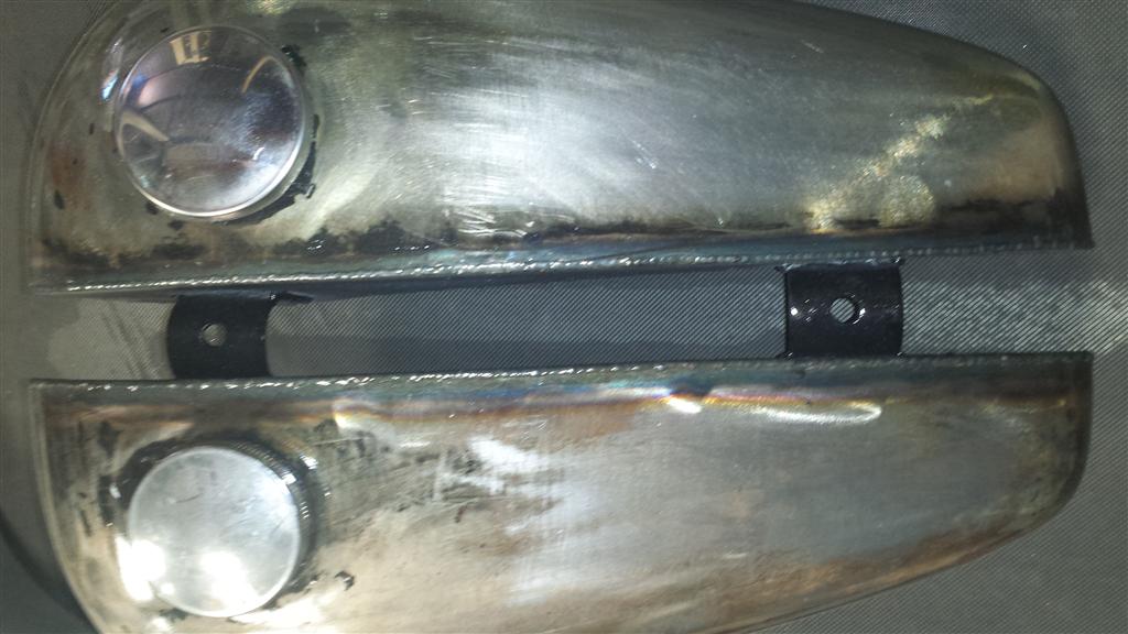

    hi mate i was wondering how you mounted up the split tanks onto the frame.im building something similar and with the same petrol tanks and i think what you have done with your tanks looks so much better.keep up the good work
    Like this
  • brick
    brick
    Hey guys, cheers yeah your right. I'll use a spacer in the bottom guard mount and shorten the top ones to try and pull the radius in.
    I actually fabbed up a couple of loop mounts over the top rail to mount the tanks, I'll post a pic soon. Oh and I got the chain/belt thing sorted too Walka

    Must have been tricky getting the welds on those brackets down between those tanks!
