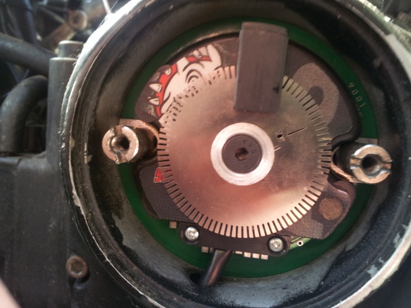

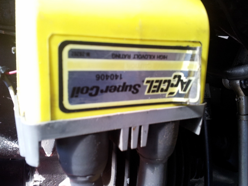

    hello people  my 1981 fxs has a weak spark problem there is spark but its so shitty and hard to see on the back cylinder and not much better on the front cylinder i think my coil could be stuffed is there any way to get my coil tested?
    and would also like help with an ID on the ignition module there is what looks like a bulldog graphic on the top left and some hard to see lettering on the bottom left i can make out the letters ""S P Y" .......spyder?
    thankyou for any help

    i would just replace it with a crane H1-4 single set up , electrics after 4-7 years are a bit on the iffy side

    thankyou daddyracer and kiwidave great advice i will definitely replace with a new H1-4 crane single fire setup
    anyway here attached is what i got back from the accel/prestoliteperformance online help desk with resistance mesurements for primary and secondary ..
    Ticket #9825: how to test 1406406 coil
    Your request (#9825) has been deemed solved.
    To review, comment and reopen the request, follow the link below:
    http://help.prestoliteperformance.com/tickets/9825
    Stan, Mar 19 15:53 (EDT):
    Thanks for the inquiry. The primary resistance of the Accel 140406 is 4.7 ohms and the secondary resistance is 13.4 ohms. These measurements are plus or minus 5%. Let us know if you have any further questions.
