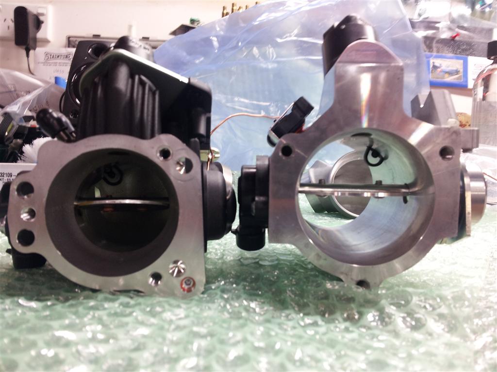

    107, 10.5:1., TW 777, 1.900" Intake 1.610" Exhaust, CNC porting, dont have port sizes or flow values yet.
    Stock throttle body is 46mm and injectors are 3.91. I think this is going to be a bit on the small size. The SE stg 4 uses 58mm and  I think 6.2 or 5.3 injectors.
    58mm I am concerned might be a bit big and may loose some velocity although it should flow heaps of air.
    Any suggestions on the best likely combination? maybe 50mm SE AND 4.3'S
    Should I be changing the manifold as well to match the throttle body?

    50mm SE throttle body is one piece & comes with the 4.89 injectors, flanges & seals, IAC & all the other sensors. For the price, it's pretty good value & will work well with your combination. Although the HPI 51mm or 55mm pieces are better & dearer, they only come supplied with the flanges. - Rob

    I run a 107 11.2 to 1 compression 2" inlet and 1.625 exhaust ported heads from Tman and his 662-1 cams, and i am running a HPI 55mm throttle body and manifoild with SE 4.9 injectors goes like a cut snake, no throttle lag at low speeds and runs hard when the cams kick in.

    for what ever reason I didn't even think about this area until today. I got a few weeks before every thing arrives but I would like to sort this area before it all gets here.
    I was thinking 55 but really need to know more about my port size first I think. Then need to peace it all together.
    Guess I can blend the 50 SE to the ports and wouldn't loos anything over what I have now thats for sure.
    Wouldn,t the throttle body have a cfm rating for each size as to how much it can flow . Then , with the cubic capacity of your motor and the max revs it will go then be a calculated cfm figure ? Just thiking out loud .

    stock one will work but will be leaving some behind.
    I dont have the info on the heads, still waiting for it
    I am looking for all torque with good response and the HP will be what ever it is so the SE 50 with 4.3 I think will be ok. 58 may be to much I think.
    can always swap the 50 out down the track if need be.

    your correct as usual 4.9
    Yea I'll blue it when the heads arrive and blend it to match, clean every thing up a bit also
    450 complete delivered which I thought wasn't to bad considering local mob was 535

    I've got the 58mm with 4.9 injectors, Tuned right it has perfect manners.
    Really grunty down low and heaps of top end and sharp and instant throttle response.
    Don't know why the 58mm TB get bad press. Just not tuned right I guess..
    I'm no expert but been around car injection a bit.
    Haven't really seen any proof that a TB can be too big within reason but have seen properly tuned larger TB's make more torque and HP right thru the rev range.
    What to others think?
    Stock 46mm and SE58mm
