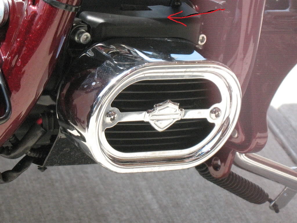

     check inside your voltage/regulator cover there is a spare in there. there is mine anyway.

     Thanks Will and Nomada.  Went through the WS manual today and there's no spare that I can see, only the Deutsch 6 pin.  Also looked at the section under the voltage regulator and all plugs used - confirmed in the WS manual too.  Checked again under the seat and no spare.  I guess they only have the Deutsch 6 pin as that's all that's regularly used by the workshops.  Bugger!
