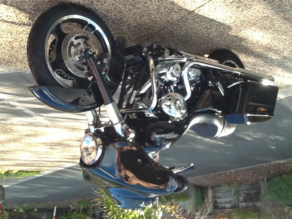

     Just bought a Street Glide, new, the dealer mechanic mentioned a problem with rear shocks locking up! Guess what, thought I would adjust the new suspension down a little, because it was a bit hard.......the knob was set to zero and I had no movement. Of course this will be a warranty thing? In the next few days, but does anyone know of the problem, how to fix it, and will it reoccur ?
    Ah that an easy one, i think that as your wheels are pointing up in the air the suspension may well be having some issues! Hope this helps.....
