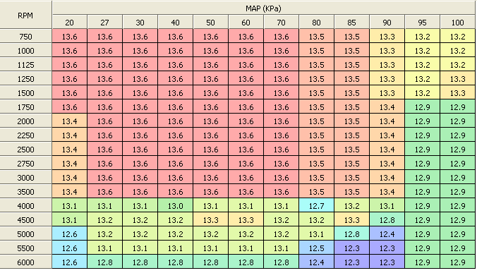

    StinkFinger the PE mode is activated when the throttle position exceeds 95% and the RPM has reached the level set in the Cal, the RPM switch point is adjustable, the AFR can be set to whatever and for how long in seconds, the AFR gets richer over time to help prevent engine overheating, an example:
    There is also a PE spark table that is adjustable to get maximum torque in conjunction with the PE AFR, PE spark adds timing and has to be done with care. Best left to the dyno imho.

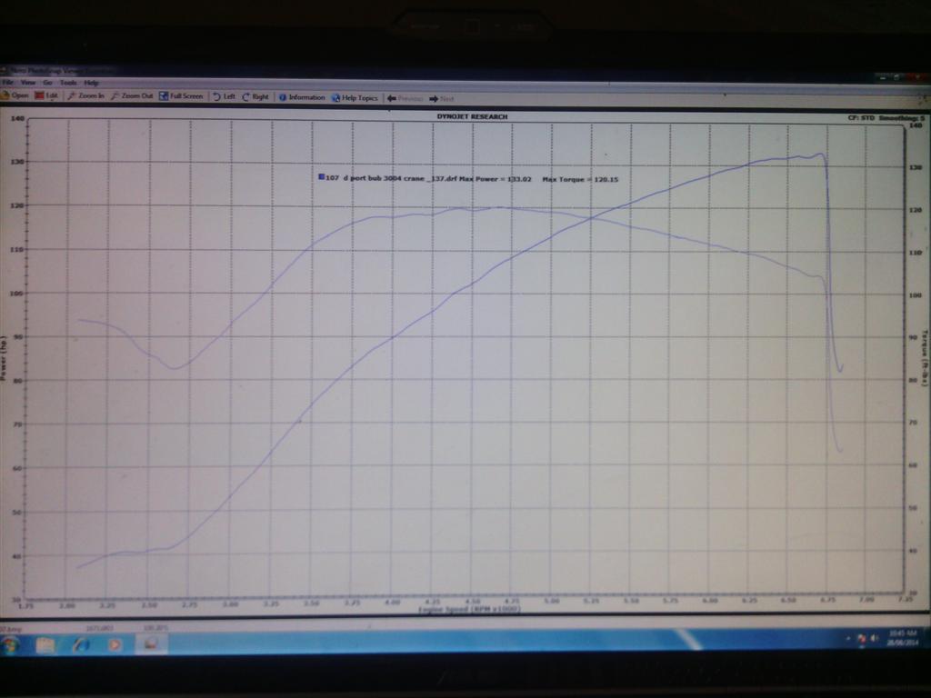

    not realy , just worked out how to use new phone and down load pics :), hilly , will be able to put some head flows now , with different size valves and csa ,
