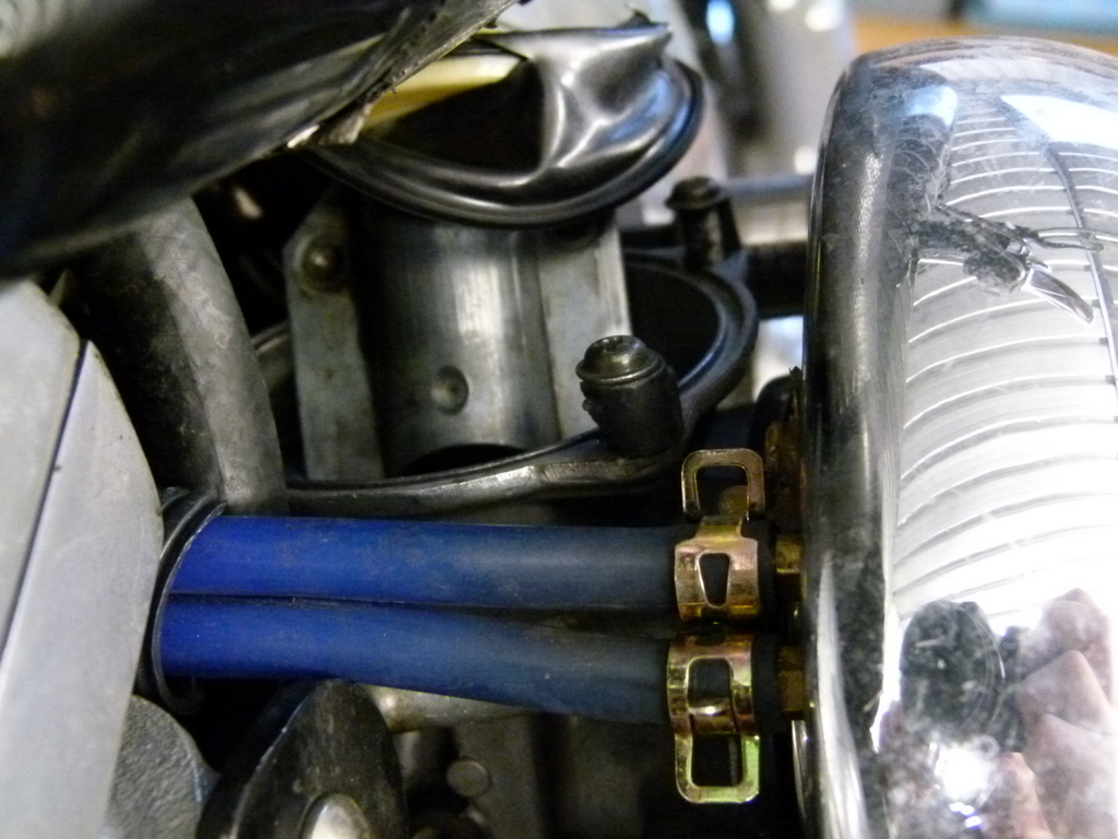

    FOUND IT! PaulyBronco was the closest. After loosening all the bolts I was about to rip the Cam Cover off and was thinking that there is no way the carb would blow off the bike, but lets have a gander anyway before I delve in too deep.
    The Carb is still there BUT the top of the carb is nowhere to be seen!
    The boost clean blew the entire top off the carb, leaving the four mounting screws firmly behind.
    I have some pics that i will post up in a sec.
    Whew!...that was a warning and I got off real lightly this time round.
    Lucky boy! Sounds as though you have a serious boost spiking issue that results in what you are looking at now.
  • tussuck
     Well here is what I suspect is the problem!...LOL (damn cheap plastic tops)

    I am thinking the clunk clunk may have been a chuff chuff as the air was pushed out the top of the carbby. However the one massive assumption I am making here is that it was the boost pressure that blew off the top. It could have been something else giving way and blowing back into the carb causing the top to lift off - unlikely but still a possibility.
    I'm going to get a new top this morning and then do a compression test on both jugs just to be sure that the only broken bit is the carb top. I measured them about 2 weeks ago and they were at basically at 150PSI each - so I have a good baseline number to work from.
