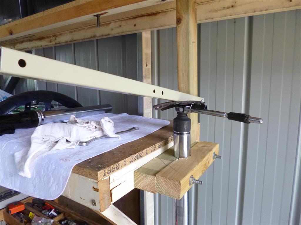

    Well it's gota be almost the easiest installation I have done.
    Do they make any difference, Have no idea and wont for maybe a month or 2 yet but lots of others say the are a great improvement.
    Took maybe 1 1/2hr start to finish all cleaned up. I did make myself a clamp and press before hand maybe 1/2hr at most couple of bits of timber and a bit of box section but made the job real simple.
