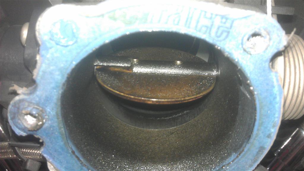

    Gday peoples just thought I would share a problem that i encountered with my fuel injected roadking .
    Erratic and running rough at idle started all of a sudden - spoke to the local harley guys and yeeer well you know could be this could be that bring it in and let us diagnose it for you Mmmmmm !!
    Jumped on a USA forum and found a problem that is well known over there - so checked mine and yep there it was a broken butterfly in the throttle body , I do all my own wrenching don't like throughing hard earned money arround . Any way ordered a new bare throttle body and swapped the sensors over and away she went .
    The only problem I have now is she is ideling just a tad to low around 750 rpm so when I get time I'm planning on drilling the butterfly stop out and threading and fitting an adjustment screw on the outside of the throttle body to adjust her back to fac settings .

    where did the broken bit of the shaft end up???
  • Denni
    Denni
    It never broke of was still connected but was on its way the screw was still holding it just -- close call !! Cheers

    Gday guys just thought I would let you know when I went to drill out the throttle stop on the throttle body , so I could put an adjustable one in It already had an adjustable screw from the factory which was awesome -- just a easy adjust and she is back to runing spot on .
    The origonal throttle body did not have the adjustment they are a pressed in non adjustable stop preset at the factory .
    Went for a test run yesterday -- road about 100klm in about 28-30 degrees celcius and it was perfect !!!
    Cheers Denni
