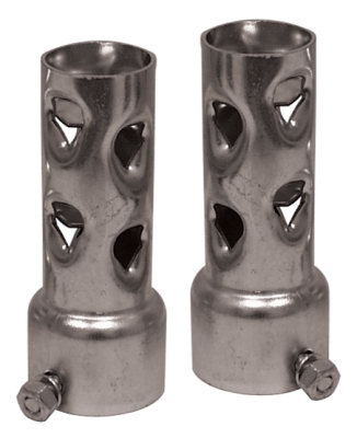

    UPDATE
    Those wee baffles I tried in the V&H pipes did reduce the noise, with a wee bit of " fluffing" at idle
    But they did " fuck the mumbo " so they're out again
    After mucho digging around the net , I came up with these , Khrome Werks 2.5 inch drag pipe baffles
    They come in the same format in different diameters and are " changeable" to suit different diameter / manufacturer pipes
    You just bend the flanges with pliers.
    According to all I've read they hardly interrupt the gas flow at all.
    Made by Acoustic Research and are the same baffles as are in AR11 and Khrome Werks mufflers.
    I have 2 sets on the way , and will again post the results.
    By fuck this CVO Springer has some mumbo and i want to retain that without the BANG on startup that the standard cheesegrater "baffles" give
