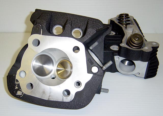

    Hi all,
    Just had my 1250 Hammer kit installed the other week. I've got a thread elsewhere on this conversion but thought I'd share some info here on my build as a couple of guys have asked about it.
    - Hammer Performance 1250 kit iron-lined with Sledge Hammer 30 deg reverse dome pistons (10.5:1)
    - Hammer Performance "Crush" porting 1.900/1.615 valves, 550 lift spring kit & 30 deg squish cut on EFI 1200 heads
    - Hammer Performance Sledge Hammer chrome moly fixed length (-.050) pushrods
    - Hammer Performance Impact 560 cams
    - Hammer Performance 3" offset Air Hammer intake
    - Buell high performance bronze oil pump drive gear
    - Energy One BTX-11 (extra plate) performance clutch kit
    Conversion done by Thundertech here in Perth (Mundaring). Probably the friendliest most welcoming bunch of blokes I've ever dealt with in a workshop. Likewise with Hammer Performance, they've been a pleasure to deal with, quick to respond to all my emails & gave me a great deal with the package.
    I've only done 230kms on the build so far & taking things easy, so can't really comment on performance just yet. Will be taking it back for the big dyno tune after break-in.
    Also had the XR front caliper done. Will be looking at speedo/coil relocations, new seat (RSD?) & suspension next.
    Cheers,
    Slap.

    Slap  thanks for posting the pic's, I like that style chamber a lot, asif flows a lot better & the swish band works.
    looks a bit like my  ol tube frame carb Buell thunderstorm heads just your valves larger thunderstorm 1.8  1.55
    aircleaner looks good too,
