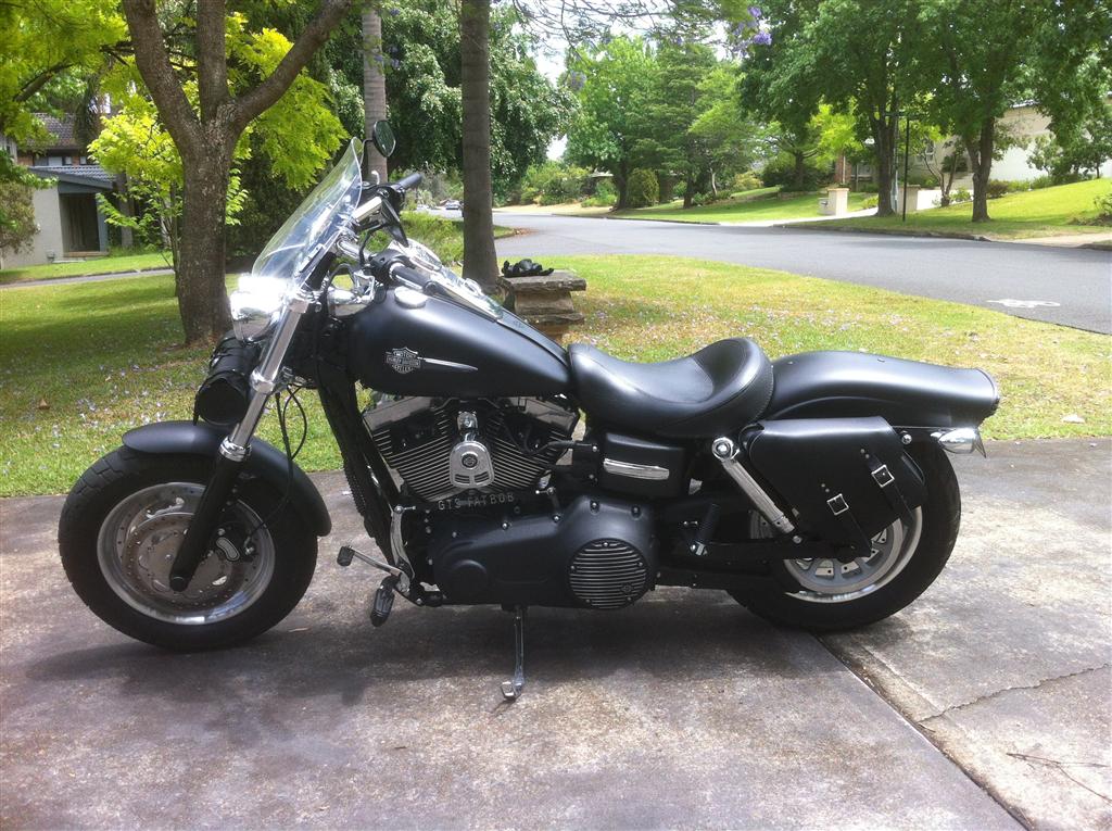

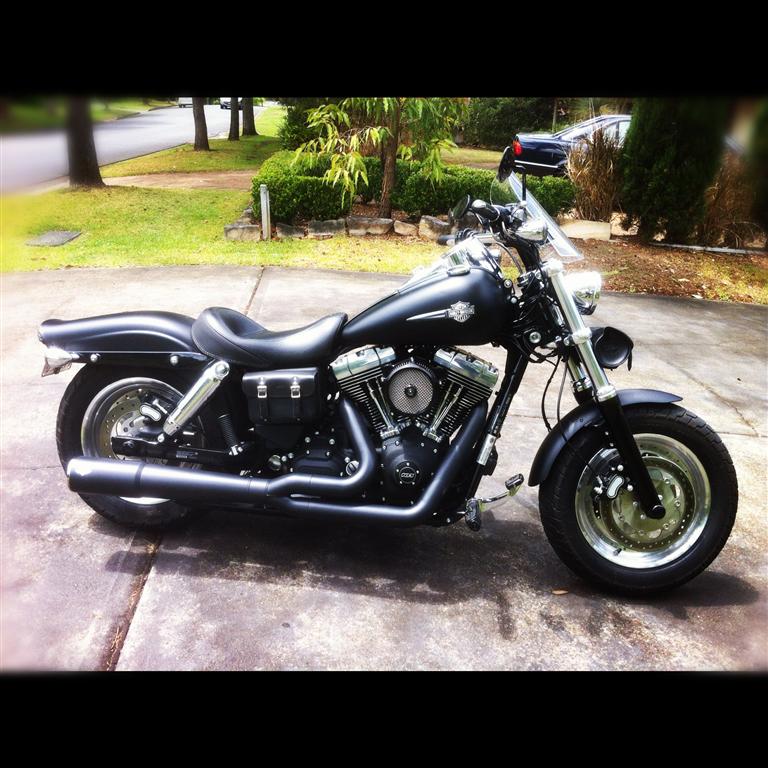

     Hi All
    Recently had S&S 106 kit installed with 640 ezi start cams onto my 103 2012 Fat bob.
    Im loving the lumpyness and grunt that its got now.
    Pulls hard from all gears and pushes you back in the seat.
    $$$ were worth it.
    The V&H pro pipe gives it a great low note.
    Perfomance machine cleaner was added after ...nothing more to do on this baby now other than some cosmetics

    good work mate, glad your happy.
    Would like to see any difference between yours and the stg4 that others have gone with
  • Ando
    Ando
    Any HP and torque fibures,,,,,,, dyno sheet
    I am interested in any other spec on the build
    what heads are you using?
    what CC are the heads?
    what compression ya set it up at?
    That cam likes a high compression ratio and I would image it could be soft of the bottom if not set up right
    Reason I ask is I am helping a mate with a high compression HP build and I am interested in what ya set up is, we are look at the new feuling Reaper Cams
  • superroo
    superroo
     Hey Ando
    No dyno results yet...may get around to doing it sometime
    The builder used the stock heads but ported them
    Stock throttle body
    Unsure of the compression ration so Im not really much help to you at the mo
    Doesnt seem to be any dead spots in the power range with roll on
    Really happy with the outcome
